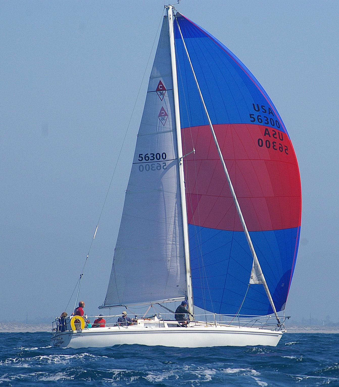

On Maverick we use an assymetrical spinnaker anytime we know we are going to be reaching from 90 to 140 degrees or so apparent. Often times on a longer race such as the Newport to Ensenada we use the drifter as a spinnaker stay sail. this set up really works!
Keep in mind I race with a crew that has been with me since I bought Maverick 6 years ago.
The tackline is connected to the anchor bail and we have a spliced continuos spin sheet. The turning blocks are tied to the aft cleats on both sides of the boat.
The pic is from a local race in the Santa Barbara Channel. Fast reaching!
PS. we can carry this combo up to about 20 knots apparent, up to close to 12kts of boat speed. after that things start to get a little squirrlley. But hey, fast is fun!

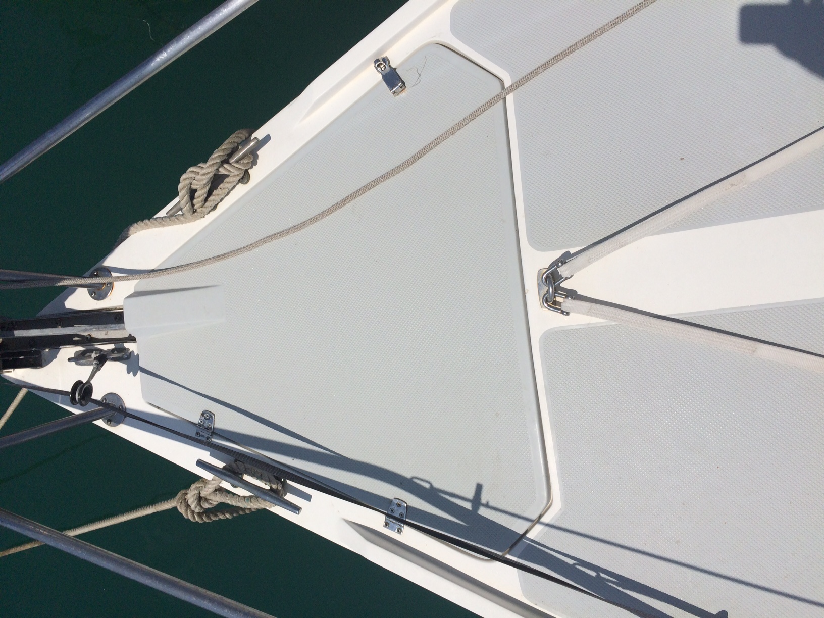

Yes, we have added a new fitting 127 cm after the forestay, it is also used to attach the lifelines. The boat is also equipped with an inner stay were we fly a Solent/Yankee (105) for heavy weather. In the enclosed picture you can also see the attachments close to the bow. The staysail is just hoisted like the asymmetrical with no stay.
Defintly is NOT to be used as a storm sail! It is built in a quite light cloth similar to the Code 0. Downwind is effective from 8/10 TWS, For beam reach starts to be effective from a little less wind.
We hoist the staysail with the second genoa halyard. The staysail has a 8mm luft rope, the staysail is installed with a very small ronstan 60 continuos furling system, so we can furl and unfurl the sail and state how performances improves or not.
