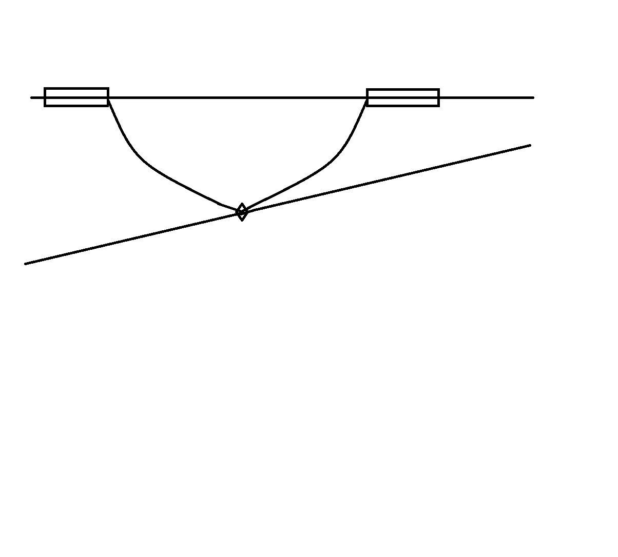

[QUOTE=hilbre;17520]... so could not use more than 4:1 scope-all chain. When it hit, we swung to 26' of water so now down to barely 3.5:1 [/QUOTE]
Hi, John. I guess I am going to be "one of THOSE guys" by telling you that unless your anchor dragged, your scope did not change at all. What determines the scope is the vertical distance between the anchor and the rode's attachment to the bow. How much water is under your boat makes no difference at all.
I used this example on one of the quizzes I designed for a course I taught, and, yes, it is a tricky thing to wrap your head around at first.
The very crude sketch shows the boat in two different depths, but the vertical distance to the anchor is the same and the angle of the rode to the anchor is the same.

Duane:
I guess I would have failed the course! You are correct, sometimes you forget your Geometry.:D

[QUOTE=deising;17522]
The very crude sketch shows the boat in two different depths, but the vertical distance to the anchor is the same and the angle of the rode to the anchor is the same.[/QUOTE]
Very true, Duane. Having said that, when the boat is over the high ground it would have to drag the anchor uphill, the angle of 'uplift' on the anchor stock will be less, so the effect is [I]similar [/I]to having more scope. Mind you in this situation you likely have a [I]lee shore[/I] so you want all the holding advantage you can get! ;)
