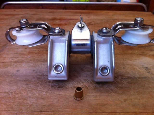

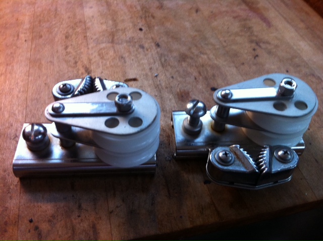

My traveler started leaking rainwater into the cabin, so it seemed like a good time to overhaul it. It is original from 1984 and the plastic sheaves were all broken due to sun exposure.
Yes, I realize I'm giving up a bit of racing advantage with the curved traveler, but being essentially a cheap bas#&*d, I did not want to spend the $800+ for a new traveler when all the metal in this one still looks perfectly serviceable (remember this is was freshwater boat most of its life).
It was not hard to ream out the riveted shafts. In fact the hardest thing was just finding new sheaves of proper size (West Marine) and new sleeves (Shell Lumber in Miami) in the sheave holes to protect the sheave from wear on the new threaded bolts going through them. I'm not totally happy with the bronze sheave sleeve in the stainless sheave (in one of the pics), but that's the best I could do thus far.
Here are pics of the results.

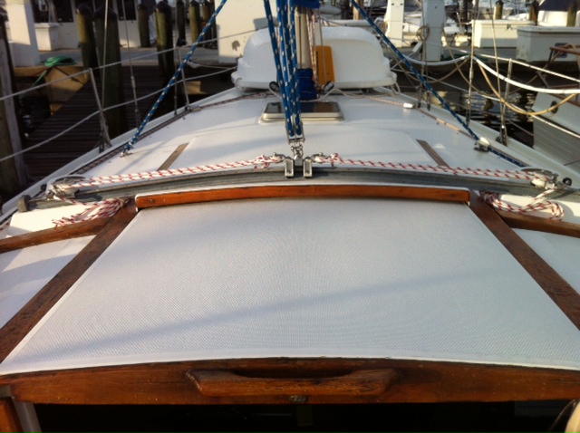

...and a pic of the finished traveler, now that it's stopped raining for a minute. :-)

On your traveler car you have the bolt or screw (new axle) installed from the bottom up terminating in a nylock nut.
Consider a screw or bolt long enough to have atleast 1 and as many as 3 threads protruding through the nylock nut so as to insure the nylon has engaged the screw or bolt.
Also, consider when possibe, install bolts and screws from the top where no interference will be created so if for some unforseen reason the nut did come off the bolt would not fall out too.

My thinking was that (a) I didn't want any sharp threads sticking out and (b) I wanted to be able to see the nuts in case they started working loose, but what you are saying makes a lot of sense. I think I'll change to that. Thanks for the tip!
