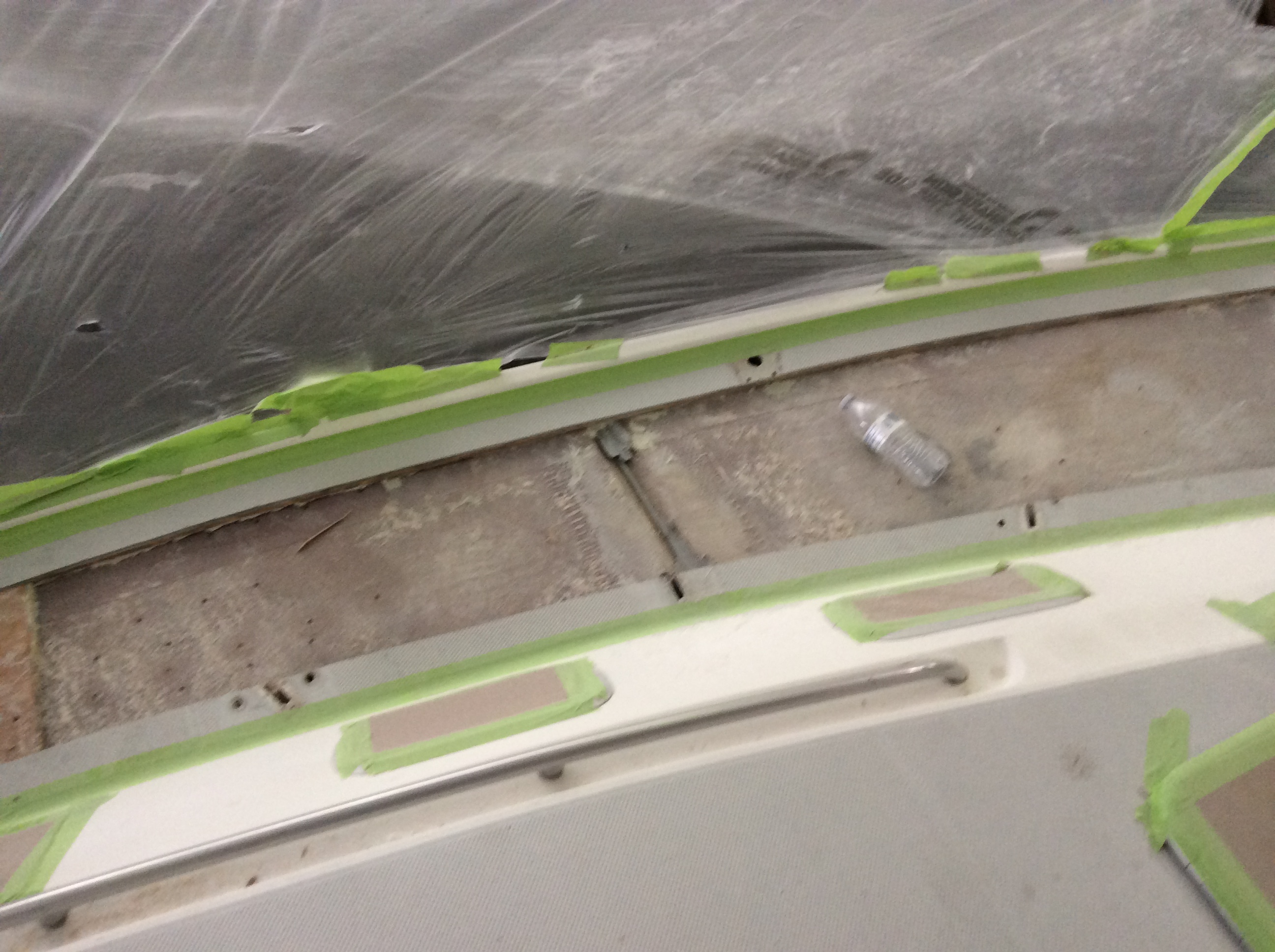

We are in the process of having the wet portion of our deck repaired. Approximately 8' at the shrouds on each side. Evidently caused by a p*ss poor bedding job by the CO is the source of the problem. An expensive lesson to be sure.<br /> <img alt="" class="image-medium" src="/sites/default/files/styles/medium/public/forum/Evergreen%20Dreams%201.JPG?itok=SG5eFUL-" style="height:164px; width:220px" />
