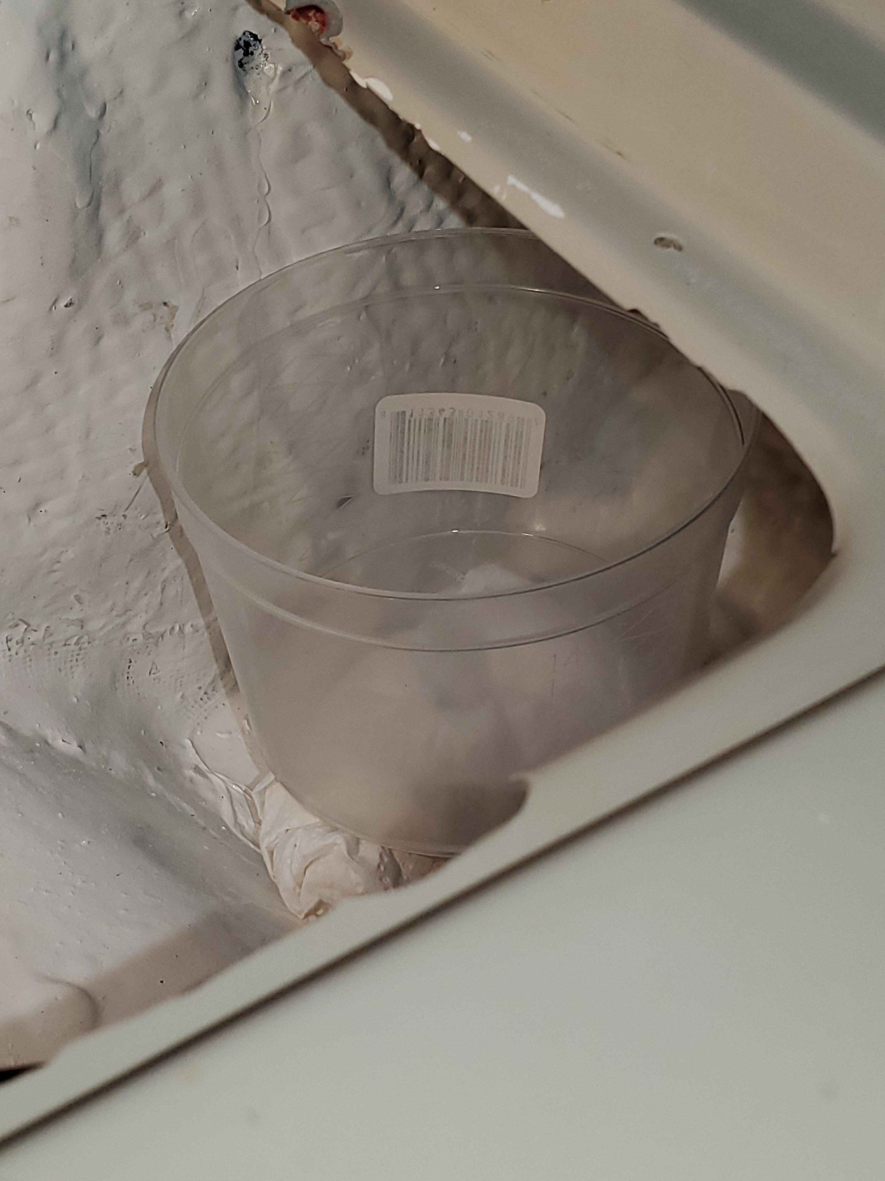

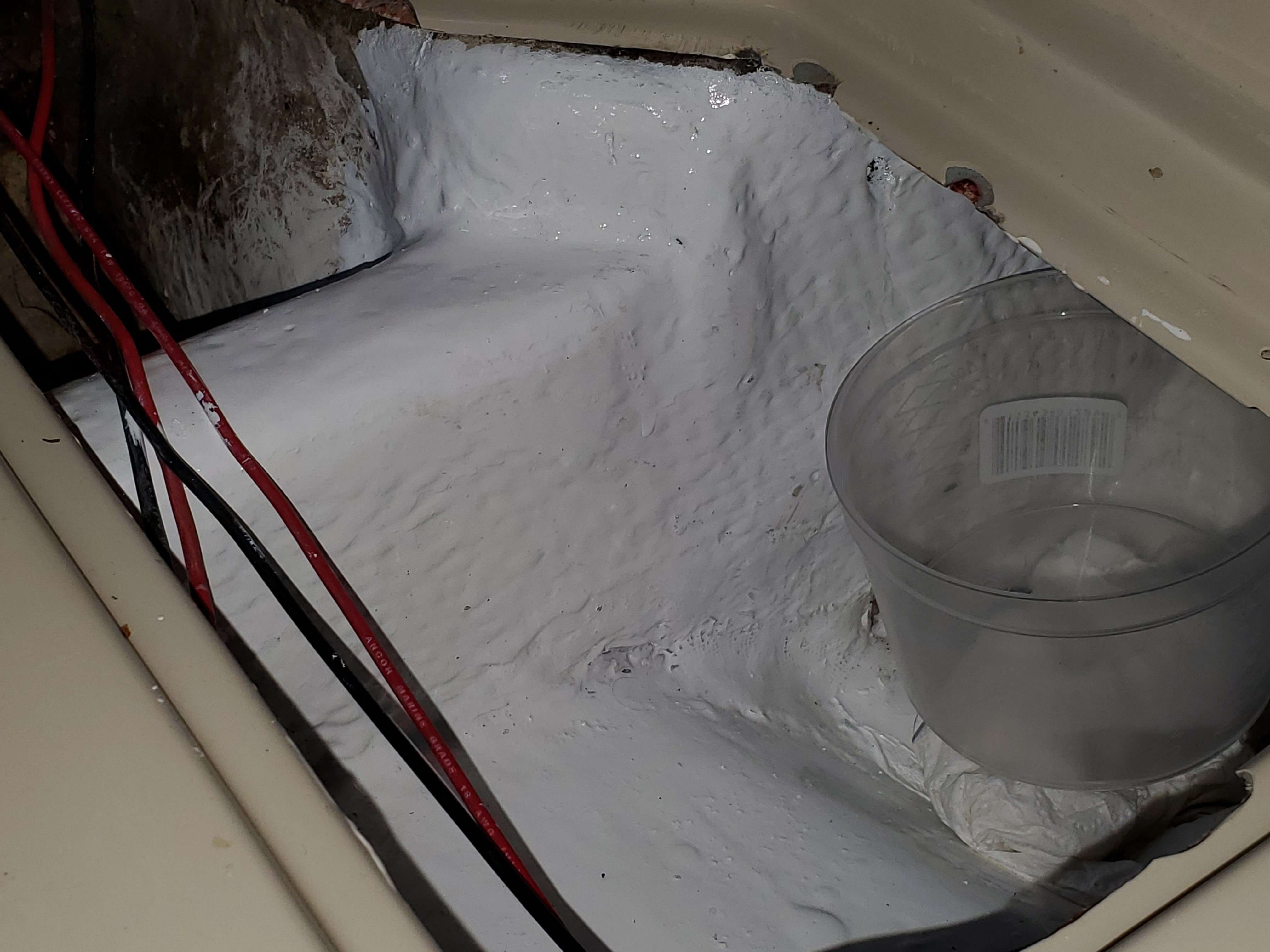

I have a leak in the small bilge just in front of my mast.  I am pretty puzzled.  The leak exits about 3 inches below the mast base into the small bilge zone.  I think the hole is at about 45 degrees aiming for the middle of the mast base somewhere.   Water is definitely coming when it rains - a slow drip.  I do not have a furling main sail.
I tried to run a bamboo skewer up into the hole  and see if it was hollow.  It got stuck about an in. 1.5 inches in.
That is fresh bilge paint there.  You can see the drip coming down over the little cup in the second photo.
Is this a weep hole that was made intentionally?  Or do I have a problem here?
Where did Catalina typically put the weep holes at the mast base?
Thanks!

Mine does the same. When it rains the lines that enter the mast bring in the rain water due to  capillary action and water ends up at the base of Mast and in your bilge.
I use a srynge and pick up the water and dry the area each week. I believe this water may cause the Catalina smile problem by permeating down the keel bolts nearby. To prevent this I placed 2" tall plastic cylinders around the keel washers and places ample 3M 4200 around them. This has provided a good solution.

   - on my boat 1988 hull #828 there is a weep hole that runs 45 degrees at a downward forward angle so the mast
    base drains straight forward into the forward small bilge and around the forward keel bolt. The weep hole is just in front of the mast.
   - know where your weep holes are.  Inspect them regularly.  Keep them clean.
