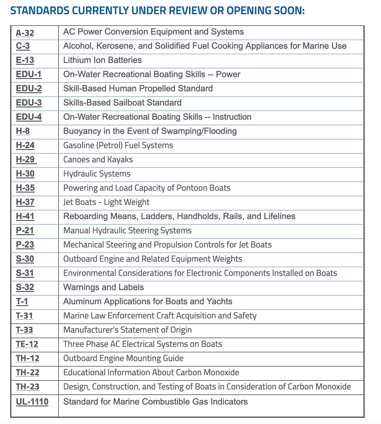

I don't see a standard for water tanks in the ABYC standards. Hmm? Just for the record if ABYC decides to make new standards or amend current standards it doesn't mean that boats manufactured before those standards have to be upgraded to the new standards. I have the same problem with my C36. The tanks leak, the bilge turns on then they find a state of equanimity then I am at peace. One with the tanks.
