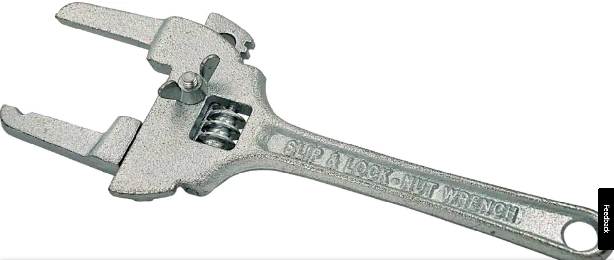

Tighten the brass nuts on the shaft.  I bought a special thin wrench for the purpose and leave it next to the stuffing box.  It cost $20, plus you need another wide mouth set of pliers.  With the engine idling and prop spinning tied to the dock, tighten the inner nut so that only one drop comes out per second or two, then tighten the outer nut against the inner nut.
