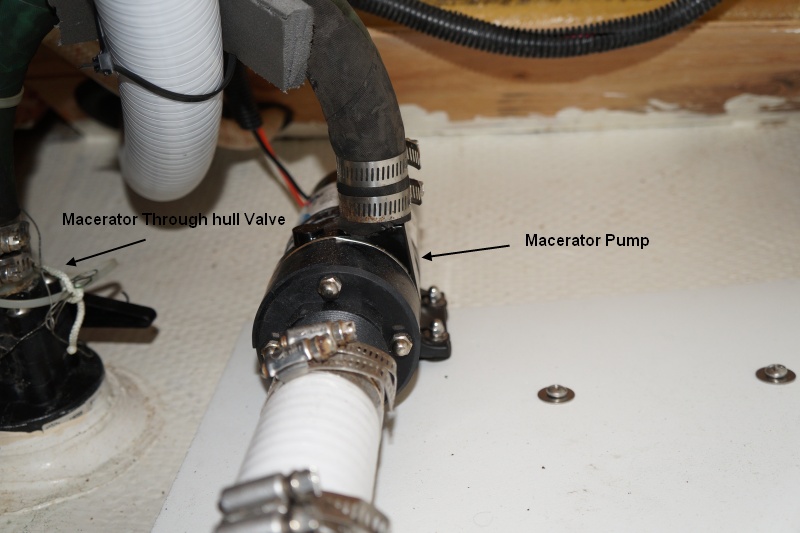

My macerator bolts also failed and the unspeakable filled the the bilge.
After I purchased a new one, I replaced the 4 bolts with stainless steel screw rods. No problem after 4 years.
The reason the bolts broke, I think, was mostly because it was not installed properly.

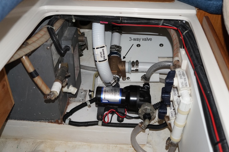

The macerator must have a flexible hose attatched to its intake side. Originally it was attached to the holding tank with a "PVC "T" splitter. As the hull flexes the impleller houseing causes the bolts to break.
I added a 3-way valve, as it is needed to develop vacuume while using the pumpout hose. Also if the macerator bolts break there will be no spillage from the holding tank.
To pass Cost Guard requirement in protected waters - the valve handle must be secured with a zip tye in orienatation that closes the macerator intake.
