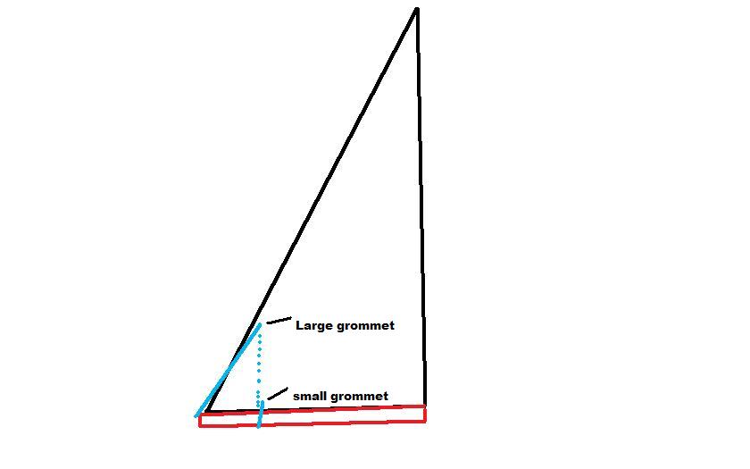

My mainsail is stock Catalina from the factory. I whipped up a quicky drawing in Paint. The blue reefing lines come out of the end of the boom, up through the grommet, down the other side of the sail (dotted blue), under the boom through a smaller grommet at the foot of the sail, and the tail of the line ties off to the same line on the other side of the sail. So the 'pull' is both down and toward the aft end of the boom.
I'd personally like a short track on the end of the boom, so I can adjust where the tail attaches. I too, think that a bit more pull toward the end of the boom, would help to flatten the foot of the sail. I plan to redo the whole system with blocks to reduce friction, and will probably add the tracks/cars at the same time.
Hope this makes sense
