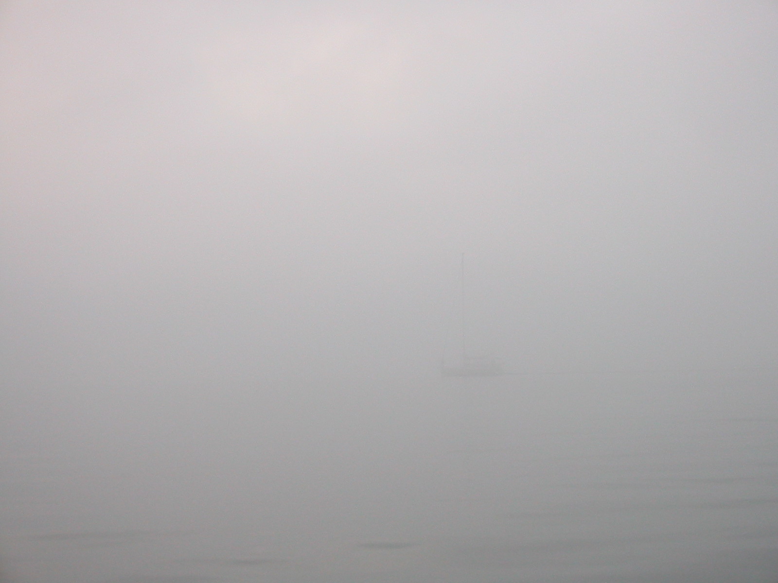

[ATTACH]347[/ATTACH]This was taken outside of Stonington Harbor CT. It was not the time I described above, it was another time and it was not as bad a fog as the time above. (try and spot the sailboat in the picture :rolleyes: )
