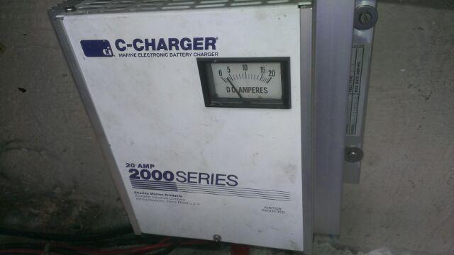

So, yes, it would be helpful if you could let us know what make and model it is, and a picture may even help, too.

Here is a picture of the battery charger....
It is a C-Charger 20Amp 2000 Series.... What say you?

Pretty basic unit, I just read their docs from their website which says it goes into bulk charge at 14.5 volts for 4 hours then into float at 13.6 for flooded lead acid. That's not the way a really good charger does it. There are no adjustments. Almost sounds like a ferroresonant unit with a timer but maybe not. At any rate, appears to not be a high end unit. A timed 4 hour bulk charge at 14.5 volts on a battery bank that does not need it will definitely increase water consumption.
I agree with Bud that the charger is definitely not a high-end unit. Can't say it is your problem, but I had a charger fail on me and it was cooking the batteries by severe overcharging. The only way to tell (that i know of) is to measure the voltage it is applying at various stages of the charging cycle.
An expert would advise you better, but I would try this: Check that your electrolyte level is good. Disable the charger then discharge the battery bank a bit so that the resting voltage is perhaps 12.5 or so. Then turn on the charger and measure and record the voltage with a multimeter. Take measurements every 15 minutes and see how it behaves until the voltage stabilizes at the float value (factory set for 13.6V).
If it takes hours and doesn't seem to ever drop to 13.6V or so, then it "may" be overcharging. BTW, the capacity of your battery bank plays a role in the time involved with a larger bank taking longer to recharge, especially with a small 20A charger.
Tony,
Bud and Duane have identified the major potential issues with your charger. Since you have an older boat, there's no way for us to tell when that charger was installed. In most, but certainly not all cases, the presence of an ammeter on a charger means it's pretty old, and perhaps built before true three stage charging (plus equalization) came into being based on proper battery charging regimens promoted by the Ample Power Company in Seattle in the later 80s.
Over the course of many years discussing chargers, we identified some that were questionable, Charles being among them, ProMariner FLYBACKS being the other (NOT the [B]new [/B]ProMariners which are identical to the Sterling Ultra Pros).
You might be interested in this 2002 discussion, starting with Reply #12.
[url]http://c34.org/bbs/index.php/topic,605.0.html[/url]
Good luck, if it was my boat, I'd take Bud and Duane's suggestions and start doing some voltage and time measurements to determine how the charger works, after you identify if it is one of the questionable older models.
