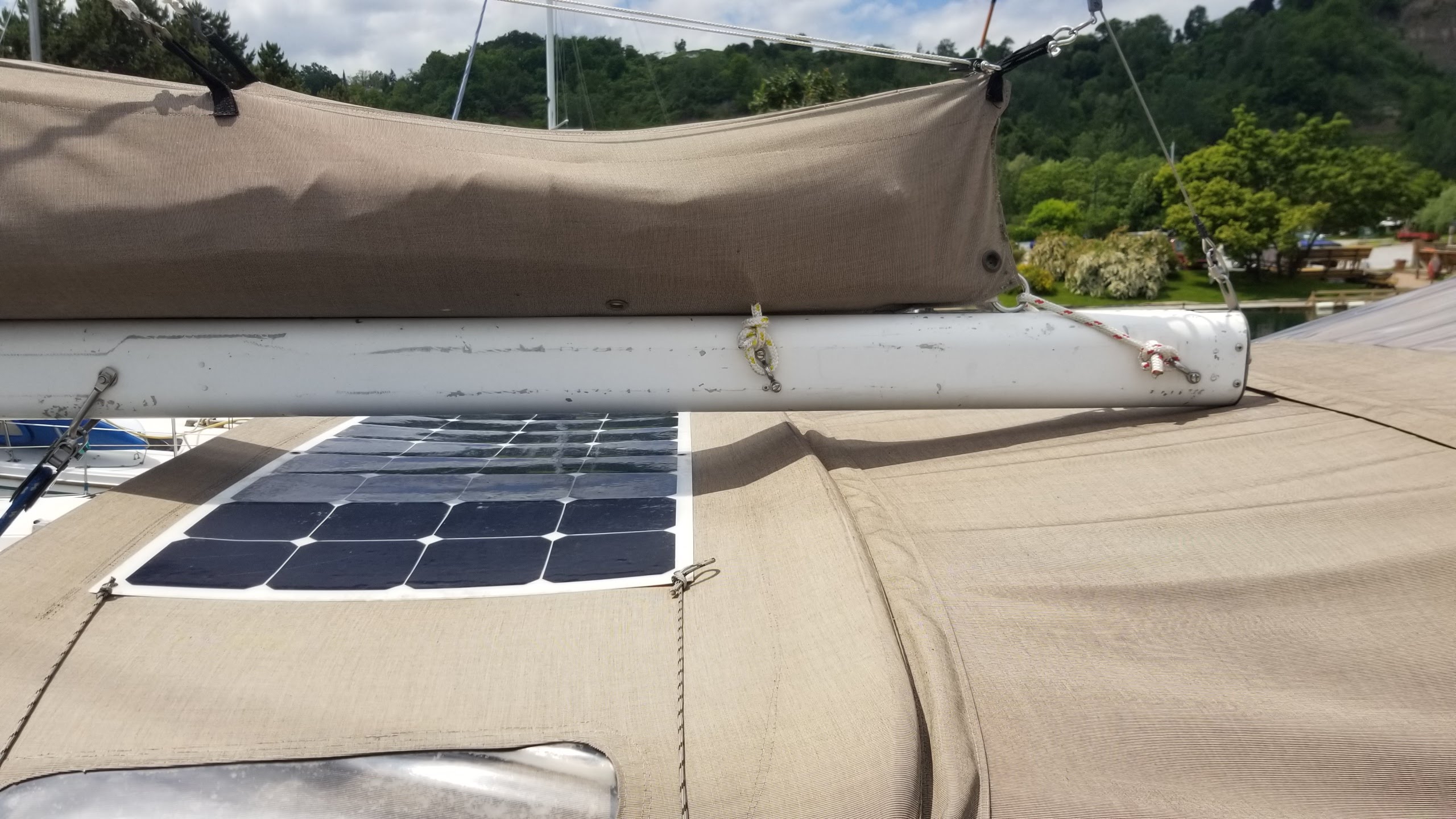

Yes, I removed all the wire and associated blocks inside the boom and have a line that goes from a D-ring on the end of the port side of the boom, through the clew and back to an adjustable car with a block on the starboard side of the boom, then forward along the side of the boom to a jam cleat near the mast on the same side of the boom.  I pull it tight in the spring and never really need to touch it afterwards (but I don't race). In the photo, the second line is a reefing line.
Image icon 20190625_140625.jpg663.67 KB
