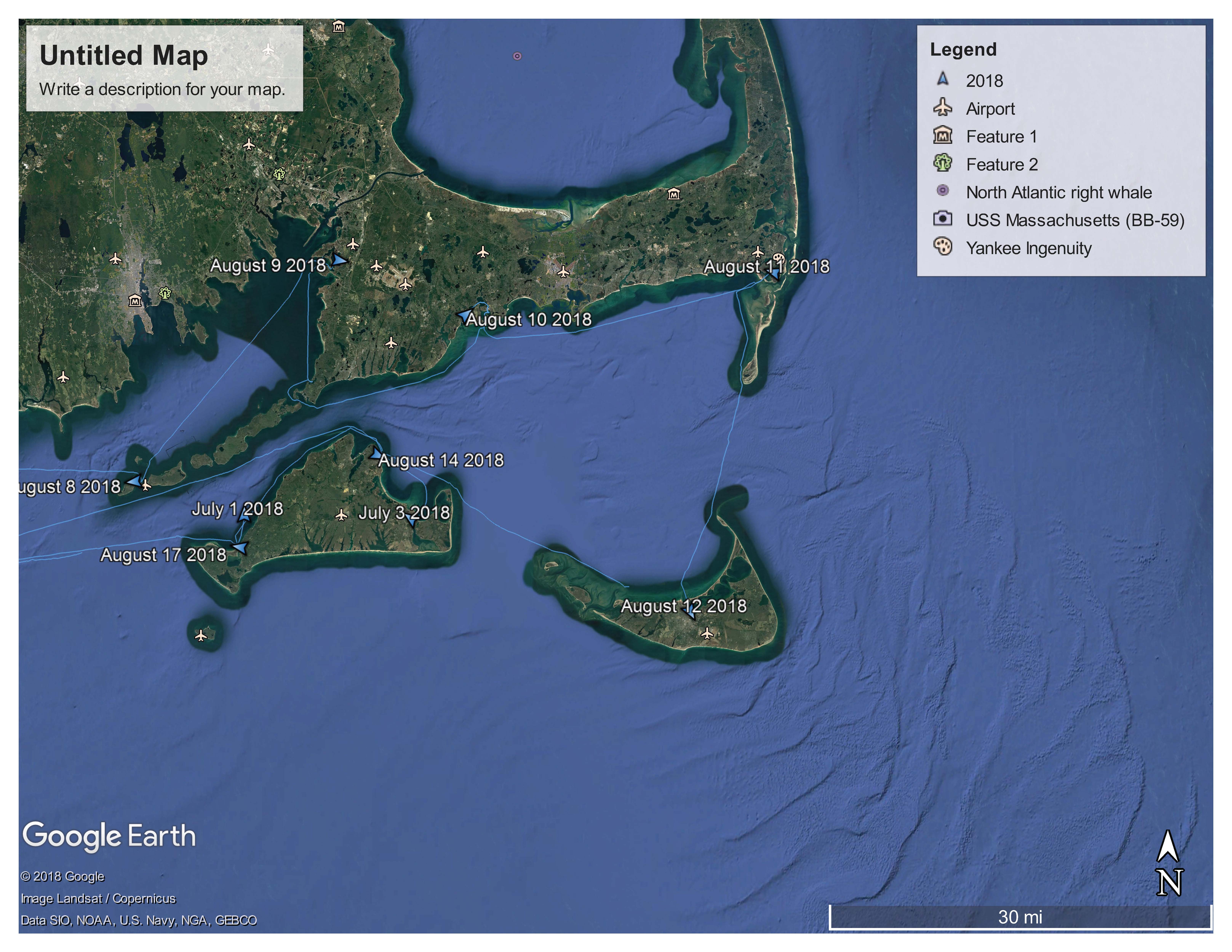

     As to the need for a wing keel in your sailing area: We often sail in the same areas as you list (see image of our tracks in the area this season), and we've never found having a fin keel to be a limitation in terms of thin water (the only possibly tricky place we haven't tried is the entrance toLake Tashoo on the Vinyard, which we're told we should only attempt on a rising tide).
