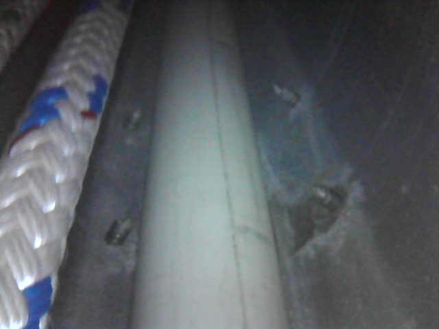

- The remnants of storm Ian just blew through, and while inspecting yon boat, I noticed a water splatter puddle on the floorboards around the mast.  I bought the boat in Janurary, but never noticed this before (or any evidence of it).  There appears to be a bit of condensation around any metal parts or on the insides of the hatches, but I don't think that it would have contributed to that much.  A picture of the mast-deck joint area (from inside) shows a damp shim.  This suggests to me that some of the silicone sealant around the mast boot has failed.  The hatch next to the mast also shows some mildew as well, but that may be just from condensation (not sure).  Any thoughts on an obvious cause?  The mast boot itself appears to still be in decent condition (no visible cracks), so I am loathe to take the mast down just for this (don't want to spend that amount of money quite yet...).  Also, are there any mast boots that can be put on without taking the mast down (wraps around)?  Just curious.
Here's a picture of the damp shim (starboard side, picture taken looking up in the cabin)

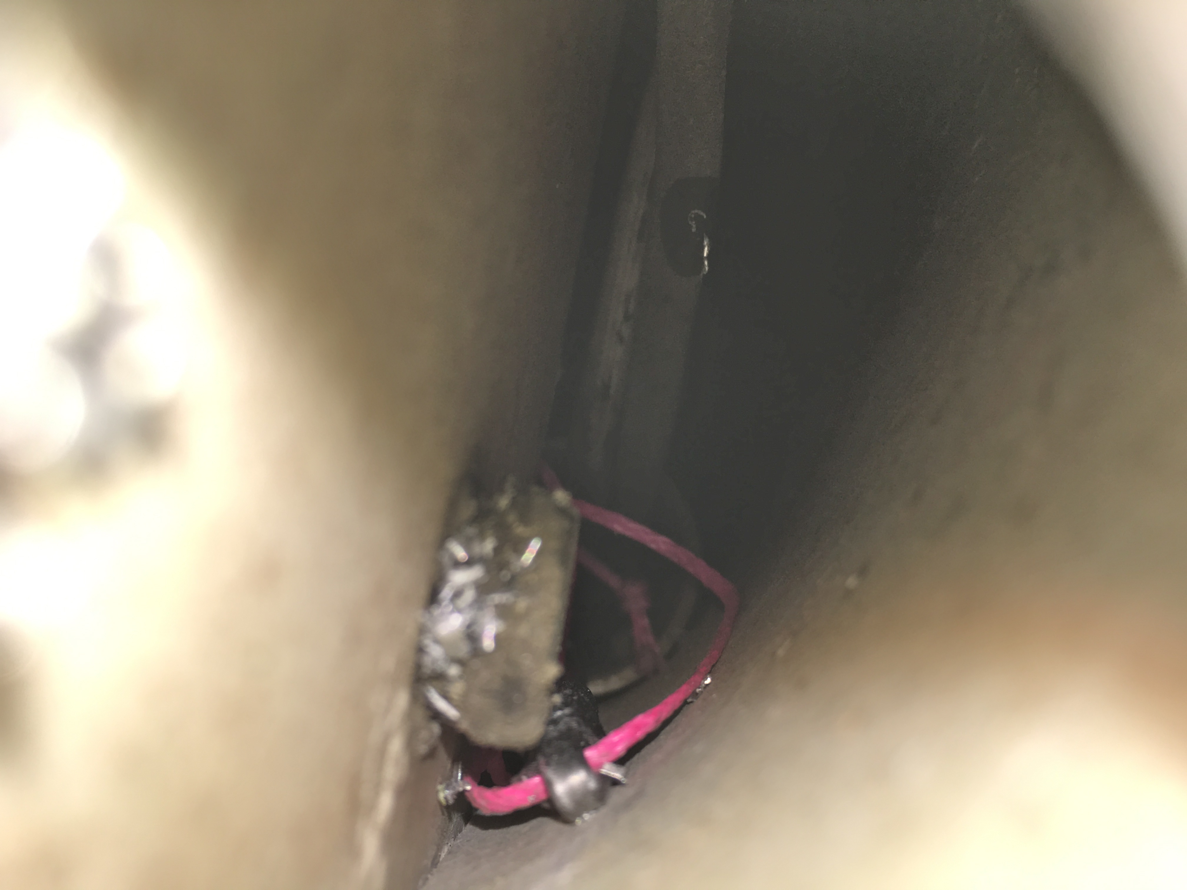

I used a 100 foot fish tape from Harbor freight and PUSHED it UP from the bottom of the mast. I have two holes at the base of the mast exiting into cabin. I used an endoscope camera (Amazon) peeking through one hole to help guide the fish tape into the conduit. Shoved it up 54? feet or so until it hit the top of the mast plate. I premarked the fish tape so I would know when I hit the top of mast instead of the spreaders, etc. Not sure the exact height. Then I drilled a hole on top of mast maybe 1/2" and I believe used another existing hole for endscope and hooked the end of the fish tape and pulled it up and out. Then attached a pull string and pulled it through, then attached new wind vane cable (Raymarine) and pulled it down. I did need my Dad to help pull the cable down as I feed it from a bag into the top of the mast. I installed 4 mast steps and used a harness and a short rope to tie into very top of the mast so I could lean back and use both hands. A bosun's chair won't get you to the tippy top. Here are some inside photos of the mast.
This is what the BOTTOM of the conduit looks like inside the mast. The light in the distance is where the halyard exits.
This is the backside of the steaming light mid mast.
TOP of conduit about a foot down from masthead.
Fish tape sticking out of conduit with a bright colored string loop to hook onto to.
