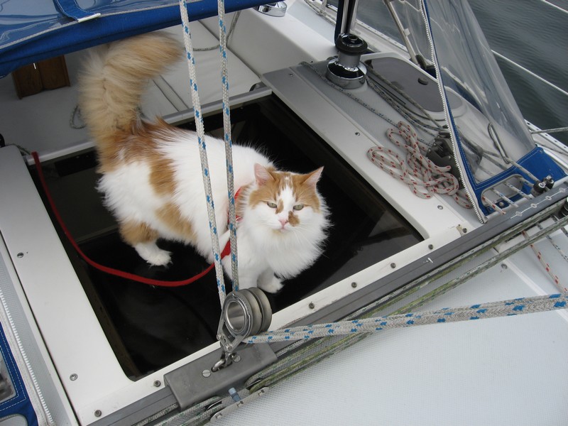

Picture of it from above on a 1995 Mk II. Later one might be different again, I don't know. That would be Sailor Spike on duty there.

Ah, the mk 2 is way different.
