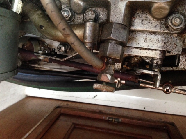

Hello
Can someone please tell me if the little knurled wheel in the picture below is the fuel bleed valve? Am I supposed to run the engine with that open or closed?
Sean

Looks as though it runs great with it closed. When I first started the engine after changing the fuel filters it died out after a few seconds even though I ran the lift pump for a while to get all the air out. I ran the lift pump for a while and could not get her restarted. That's when I noticed the little bleed screw. On my old universal M5411 the bleed didn't have a return to the tank. This one appears to run into the recirc lines off the injectors. I opened the bleed screw and ran the lift pump then started the engine. She ran with it open and ran with it closed.

Capt. Sean,
After I change fuel filters I normally start and run the engine with the bleed open for 20 seconds or so. That's usually good enough to get the air out.

When changing filters, injectors, etc. I just turn the key and pump runs open the valve for a few minutes close and start the engine. When I first got the boat I did not know that this engine had that and paid $$$ for the service at the boatyard. This is just too simple!
There should be a return line from your injector pump to the fuel tank. The lift pump pushes more fuel to the engine than it will burn and the excess is recycled back to the fuel tank. Kind of a poor man's fuel polishing system. If your tank is not full you should hear fuel running into the tank when the pump is on and the engine is not running. The bleed screw should be closed when operating normally.

Some engines have gthe bleed screw some don't.  My M35B does not.  I just changed both filters and here's the procedure I used:
  • Installed new RACOR element, removed vent plug on housing outlet, used built-in finger pump till fuel came out of vent, replaced plug.  This essentially pre-filled the RACOR filter.
  • Pre-filled new engine spin-on filter with diesel.
  • Key switch in "preheat" for 10 seconds; wait 1 minute, repeat 5 more times.  This is bleeding the small amount of air that got introduced in the lines.
  • Start engine.  I let fast idle for 15 minutes before trusting.  All was good.
If you do have a bleed screw, the proper procdure is to replace your filters, open the screw, run the lift pump (ideally independent of preheat) till fuel is flowing back into the tank with a steady stream, then slowly close the screw while the pump is still running.  Prefilling filters is always a good idea, but be prepared for some spills.

Does anyone have a part number for the fuel bleed valve?
I have an M25 Universal.
Thank you.

I had one replaced on my M35 several years ago and it is part # 300050 and checking the parts catalog for the M25 and M25XP it is the same part # for the complete assembly Torrenson has it listed at about $45

I too ordered one a while back, but it was the wrong diameter and thread pattern.
I wonder if anyone knows the size and TPI on the fuel bleed valve, because what I was sent was not metric and the wrong size.

Since the Racor is below the fuel tank, it might fill by siphon once you remove the bleed screw, but it might not.  If it does not, then rotating the finger pump should cause it to pop up.  You then depress it as many times as it takes to fill the bowl and get fuel to come out of the vent plug.  After you're done, depress and rotate the finger pump to lock it down.  Here's a link to a picture of the finger pump lifted and the vent plug removed: http://liberty.eurekaboy.com/racor7.jpg
The white plastic cover with the slot in it that's located at the inlet port is a check valve.  You should not need to disturb this.  If you do, just make sure it's re-tightened.
