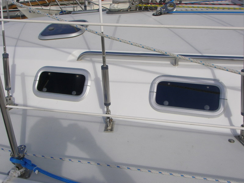

Annoyed by leaks through your port windows?

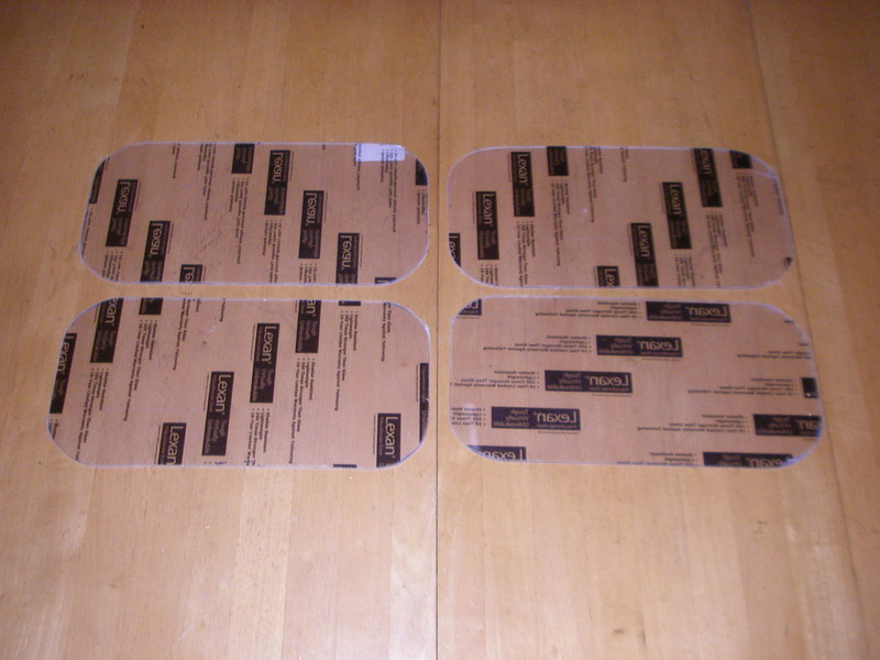

Buy a sheet of clear lexan, cut to the shape of the outside aluminum frames, and carefully attach to the outside of the frames using good clear packing tape.
Only meant to last through the rainy season here in California, this is a sure-fire way to keep water outside of the boat.
Photo Captions:
1) Cut pieces of Lexan for window covers.
2) Left port window with no Lexan, with Lexan on right port window.
3) View through window with Lexan window cover.
