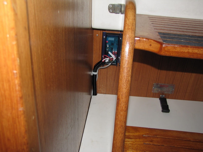

Where is your regulator located? Outside the engine space, I trust.

Thanks Stu. My regulator is mounted just behind the companion way on the bulkhead, outside the engine cover box. I think its a perfect spot for it in that its outside of the engine heat and its LED display can be read just by looking behind the stairway. I'm still a little puzzled by one issue; when I started up the engine, with batteries at 100% the regulator was telling my alternator to charge "Bulk" rate. after idling for 30 minutes it still showed Bulk when it should have gone to "Float".. They agree it should be showing "Float". (added after a conversation with Balmar): Balmar says the regulator will go immediately to Bulk rate on start up even if batteries are 100% then cycle to float after a time. It did this when I went for a longer sail, (four hours) on Sunday. Also the tach problem did not re-occur so I'm putting this one in the "solved" column. Sam
