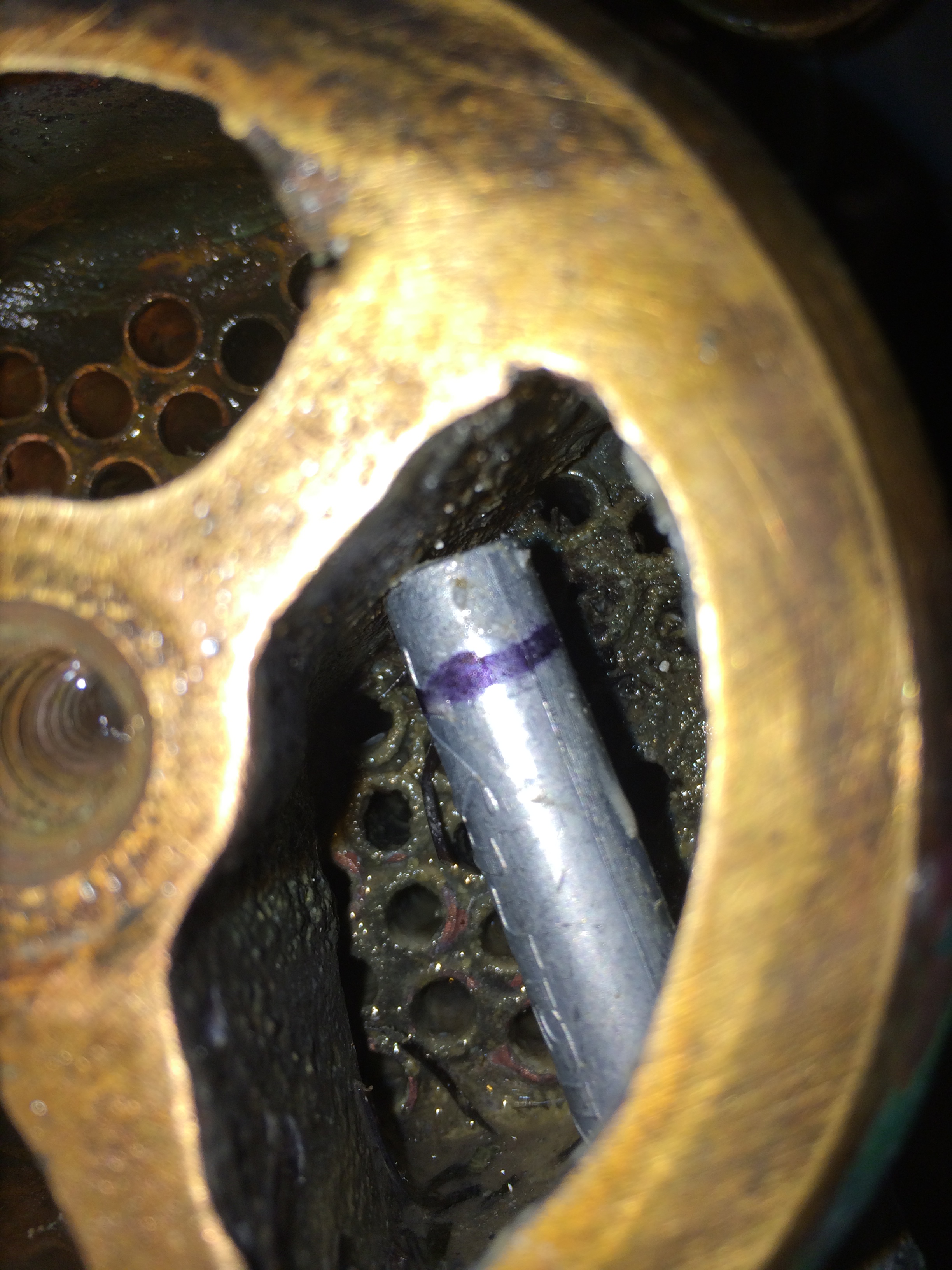

Over the years there has been a lot written about the correct size of the Heat Exchanger zinc for the 3” HEX on the M35 series motor.
There have been concerns about "punching" a hole in the HEX and like others I’ve been guided by advice in the forum to cut a piece off the standard zinc to be on the safe side.
Because of the tapered thread on the brass nut it’s difficult to feel with a spanner if the zinc is located correctly and that its not too long.
In the various parts list the zinc is listed as Part Number 11885.
This is generally a Martyr CME-0 zinc which is 1 ¾” long and 3/8” diameter which has a threaded screw base which in turn screws into a 5/16” brass nut with a ¼” NPT thread.
I have attached a photo of the standard zinc screwed into the HEX and its can be seen that there IS clearance. The blue mark is about 1/4" long. One point to note is that the NPT thread is tapered and it only needs to be lightly screwed into the HEX – definitely not all the way in as I’m sure many of us might try to do. There is little chance of “punching” a hole in the HEX as it is a sturdy casting as can be seen.

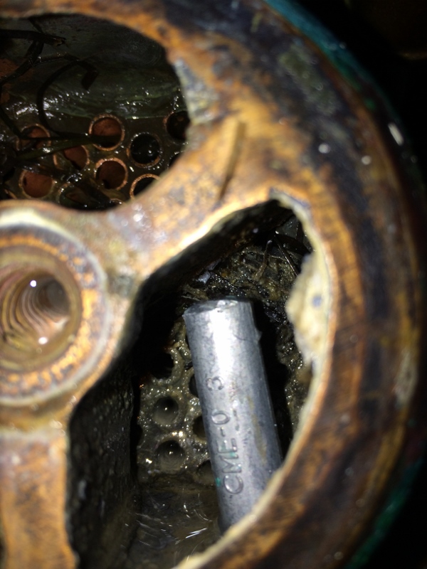

For comparison I’ve attached a photo of shortened zinc showing plenty of clearance as would be expected.

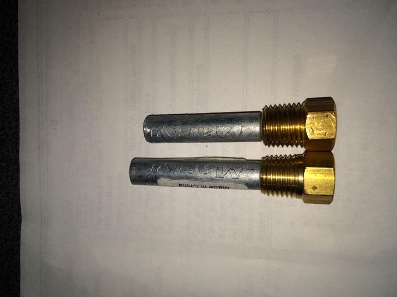

The other photo shows the two zincs side by side with ¼ “cut off one.
Needless to say I’ve been using uncut zinc for ages with no problem.
Hope this helps

Here is the first of the other two photos
Image icon Shortened Zinc (600x800).jpg211.81 KB

Heres the the Third
Image icon Comparison (800x600).jpg179.94 KB

I have always used 1/4" zinc since anything larger will not go into the HX. I do not shorten it  and I replace it every 6 months or 30 hours. Your images are very informative. I can never see it due to its location.
