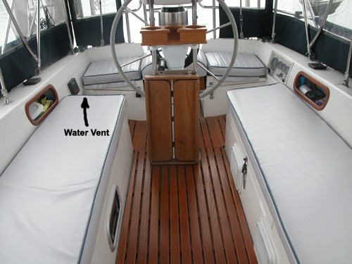

On my boat the water vent is on the starboard side between the aft locker and the seat.
Bill Matley

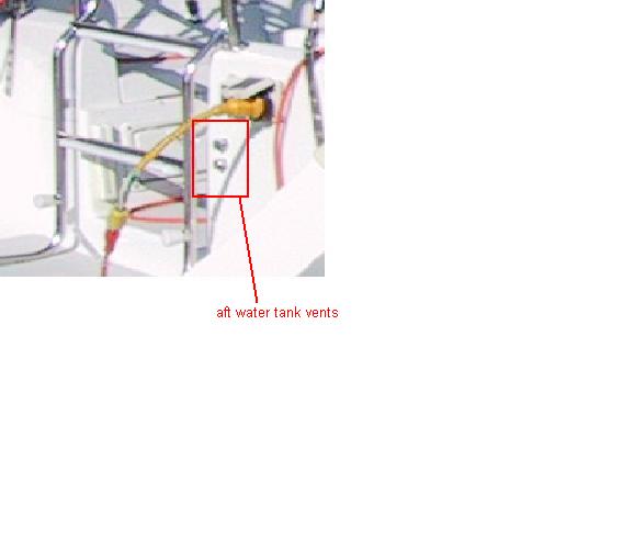

On my 1996 MKII the aft water tank vents (2) are on the transom swim step, just inboard of the of the shore power connectors on the stbd side. The single vent on the port side is for the fuel. The tank under the V Berth is vented into the anchor locker and located in the upper port side of the locker.
Sorry for the bad pic but you should be able to see where they are.

Thanks guys. I went through my pictures of the boat and found one of the transom from when it was hauled for survey and it doesn't appear to have two vents like Jack's boat. I guess I will just have to do a thorough inspection next time I go down to the boat. Funny I buffed and waxed the whole hull and don't recall seeing them anywhere so I'm suspecting they are above the rub rail, and area that I haven't got to yet. It's a bummer when your boat is a 2 hour drive from home.
