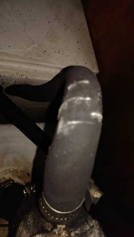

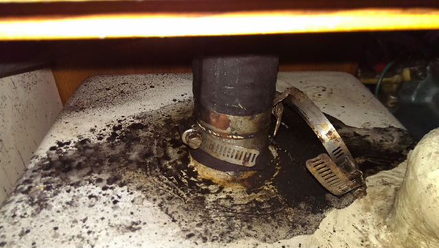

I am attaching two pictures and am hoping to get some advice on them. One is of the exhaust hump hose, and the other is of the exhaust anti-siphon hose where it connects to the exhaust riser.
My first question has to do with the hump hose picture (the one with the loose hose clamp that broke and fell down from the top part of the hump hose connection). Is it possible to replace the hump hose without loosening or removing the exhaust riser? If so, what is the best way to do it? (I'm really nervous about damaging my exhaust riser as it is rusting where it connects to the engine). Conversely, do I run any risk if I leave the old hose in place and just replace the hose clamps on the existing hump hose? I don't see any holes in it or any signs that it is falling apart.
My second question has to do with the picture of the anti-siphon hose where it connects to the exhaust riser. If you look closely the spiral metal wire is starting to pop through the top of the hose. Is this a possible additional source of my exhaust leak, or does only water go through that hose? And finally, does anyone have any pointers on how to replace these hoses? I notice that one hooks up to an anti-siphon valve inside the cockpit lazarette. Is it a job that requires that I attach the new anti-siphon hose to the previous hose and pull it through, or can I just pull it/them out, measure them, and install new ones. The only reason why I ask this is because there is a small segment of the hoses I can't see, and I am therefore not sure of any obstacles in that location that might be in the way.

I pulled out the hoses and measured them and replaced them.
If the riser is rusted enough that it may break when you work on it - then it is time that it is repaired too.

I was saying that - if the riser appears to be so rusted that may break if you disconnect the hose - then it is time to repair that now. Here is your comment regarding the the damage - ([B]I'm really nervous about damaging my exhaust riser as it is rusting where it connects to the engine)[/B]
And - yes - you can remove the hoses to the siphon break and you can insert new ones later with no problem. You will have to remove the cover that covers the fuel tank that is just behind the engine in aft birth.

My worry is backing out the bolts where it is rusting so I can lift up the entire exhaust riser to insert the hump hose on the other end. But it sounds like you are saying that the hump hose can be bent on without detaching the exhaust riser at the engine. Is that correct?
Also, I edited original to add a picture of the rust I was talking about where the exhaust riser connects to the engine. The rust doesn't seem widespread, otherwise I would imagine a rust color would have permeated the heat wrap... but there is significant rust right where it attaches to the engine.

I repaired my riser and replaced the OEM exhaust hose with a silicone hump hose. My engine is an M35A, not sure what yours is. But in my case, there's no way I would have been able to change just the hump hose, without removing the riser. I had to cut off the old hose as it had 'welded' itself to both the riser and the muffler.
My riser was leaking from a very, very small crack in the weld where the cooling water hose meets the main riser pipe. I had that welded, and reinstalled the riser. Getting the bolts off the exhaust flange turned out to be a piece of cake, they were actually pretty loose. Note that you should drain the antifreeze before removing the exhaust flange (don't ask me how I know..)
Even with the more flexible silicone hump hose, I don't believe I'd have ever gotten it on with the riser all ready in place. Maybe others have had a different experience. If I were you, I'd remove the riser, inspect it well, and if it's at all suspect, replace it. Catalina Direct has all the parts and gaskets, and others have had risers made elsewhere. Search the forum and you'll get some good hits.
Yes a hump hose can be put on with out removing the riser. It was no fun..... as others have said if you suspect there are issues fix them. If you are hauled out for the winter now is a good time for PB Blaster and every few days start spraying the riser bolts. You do not want to break them off... Hoses as many will testify are or can be a major thread to a good trip.

Joel, that is not a hump hose, hump hose is BLUE. What you have is rigid wire reinforced black hose between the riser and the muffler. The reason hump hose was invented was to replace that stiff black hose which causes vibration and wear at the inlet port of the muffler. Yes, if you cut the hump hose properly, you should be able to fit it onto the riser and the muffler with a little wiggling.
What you really need to do is to start using PB Blaster on the flange and riser NUTS at the back of the engine, so that you can eventually remove the riser from the flange and studs. I suggest you start doing the three nuts on the studs (two on top one on the bottom) with liberal blasts of PBB on a regular basis (at least weekly) right away. It might take a few months before you're able to get them off without damage. When using PBB, place a heavy duty cover over the bell housing and transmission. You do not want to get any PBB near the seals.
If it was my boat, I'd cut back some of the insulation at the flange and find out what's going on back there. Your caution is well taken. You could slap some liquid weld on it to cover the rust after you clean it up. Muffler patch paste would also work.
