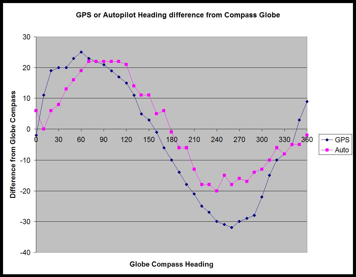

Ok, all you smart math/compass guys, now is your chance to shine.
[B]Here is the experimental set-up:[/B]
1) The boat has a "globe" type magnetic floating compass on the binnacle.
2) The autopilot has a magnetic heading sensor, located under the starboard single seat cushion space.
3) The Garmin GPS has a magnetic heading sensor located under the port transom quarter locker.
4) Both magnetic heading sensors were calibrated to the best of my ability by turning slow circles in calibration mode for each.
4) We are trying to measure the two heading sensor readings (GPS or Autopilot) relative to the globe magnetic compass reading.
[B]Data collection:
[/B]
1) Steer the boat to, say, 000 degrees. wait 5 sec. Record the GPS heading, then record the Autopilot heading.
2) Turn 10 degrees to 010 degrees, record the two headings.
3) Repeat for every 10 degrees around the compass.
4) End up with a data table containing measurements for both GPS and autopilot headings for every 10 degrees around the globe compass.
[B]
Data Crunching
[/B]
1) Find the difference in degrees between the two heading sensors and the globe compass heading.

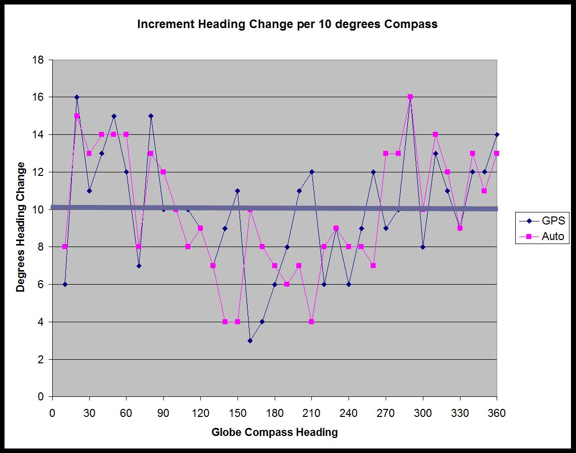

2) Find how much the heading sensors change for every 10 degrees of globe compass change.
3) Make graphs. Look at graphs.
[B]Interpretation of results[/B]
It seems that all three reading agree only at 360 and 180 degrees. At 90 and 270 degrees both magnetic sensor heading are off by around 25 degrees.
Where the sensors should be changing 10 degrees per turn like the globe compass, that change varies from +15 degrees to - 5 degrees.
What is happening here? Is my globe compass off?
What is my true reference? Are both magnetic heading sensors actually correct together?
Does graph 3 show the Deviation?

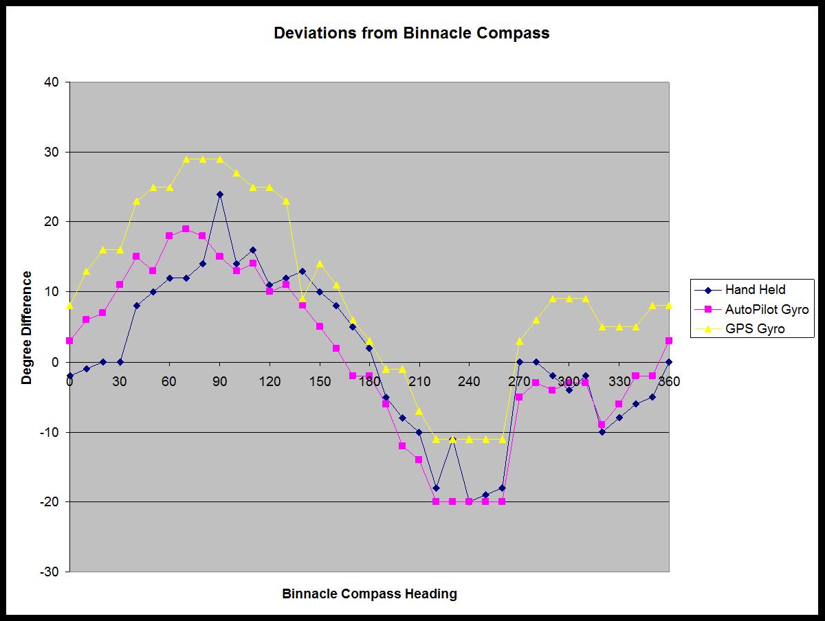

Hi Larry (and all),
Thanks for the comments.
Yes, the GPS uses a gyro heading sensor, not COG. Same with the Autopilot.
Today I went out and did one more test and data collection.
I placed a hand-held compass away from the binnacle, over on the side lazerette.
Now, again, at every point (10 degrees) on the binnacle compass I recorded the readings on the hand-held compass and the GPS and Autopilot heading sensors.
THE ANSWER:
It is clear that the hand-held compass agrees with both gyro sensors, and [B]the odd-man-out is the binnacle compass.
[/B]
I'll look into having a compass guy come out.
Will report back...
