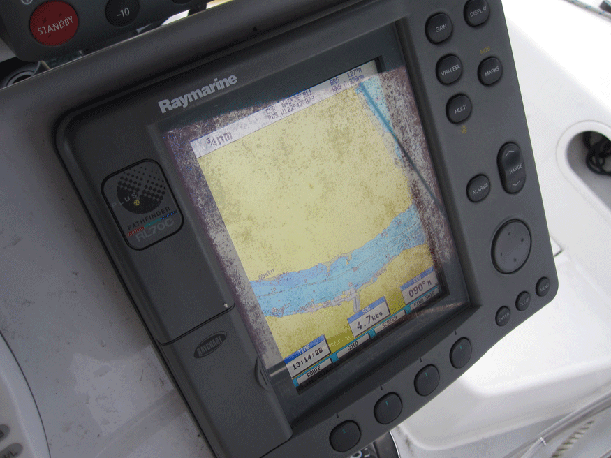

Once upon a time a crewmate applied soap to the screen of my Raymarine chartplotter, not realizing the factory non-glare coating would be damaged. I am unwilling to send the unit to Raymarine as I am sure the repair tab would be hefty. Does anyone know of a simple fix for this complex problem that can be done in the field?
I have considered removing the remaining residue entirely and then applying some computer display non-glare 'stick on' kind of product. Does such a product exist? Seems like something that 3M would have in their line-up.

I am making a wild guess, but I bet the stick on anti-scratch film that people are putting on their iPads would work...

Last year I purchased my C80 used from one of our members. The non-glare was in poor shape. I used a plastic cleaner from TAP Plastics and removed what was left. So far I have been able to live without the non-glare coating, the screen is clear and easy to read.
If you come up with something that works please post what you did.
Chris

They recommend using the kind of cleaner you get from an optomitrist to clean your eye glasses on the screen. I guess I'd try that first. I did ask Raymarine at a show once what it would cost to replace the screen and, as I recall, it was almost the cost of a new unit.
