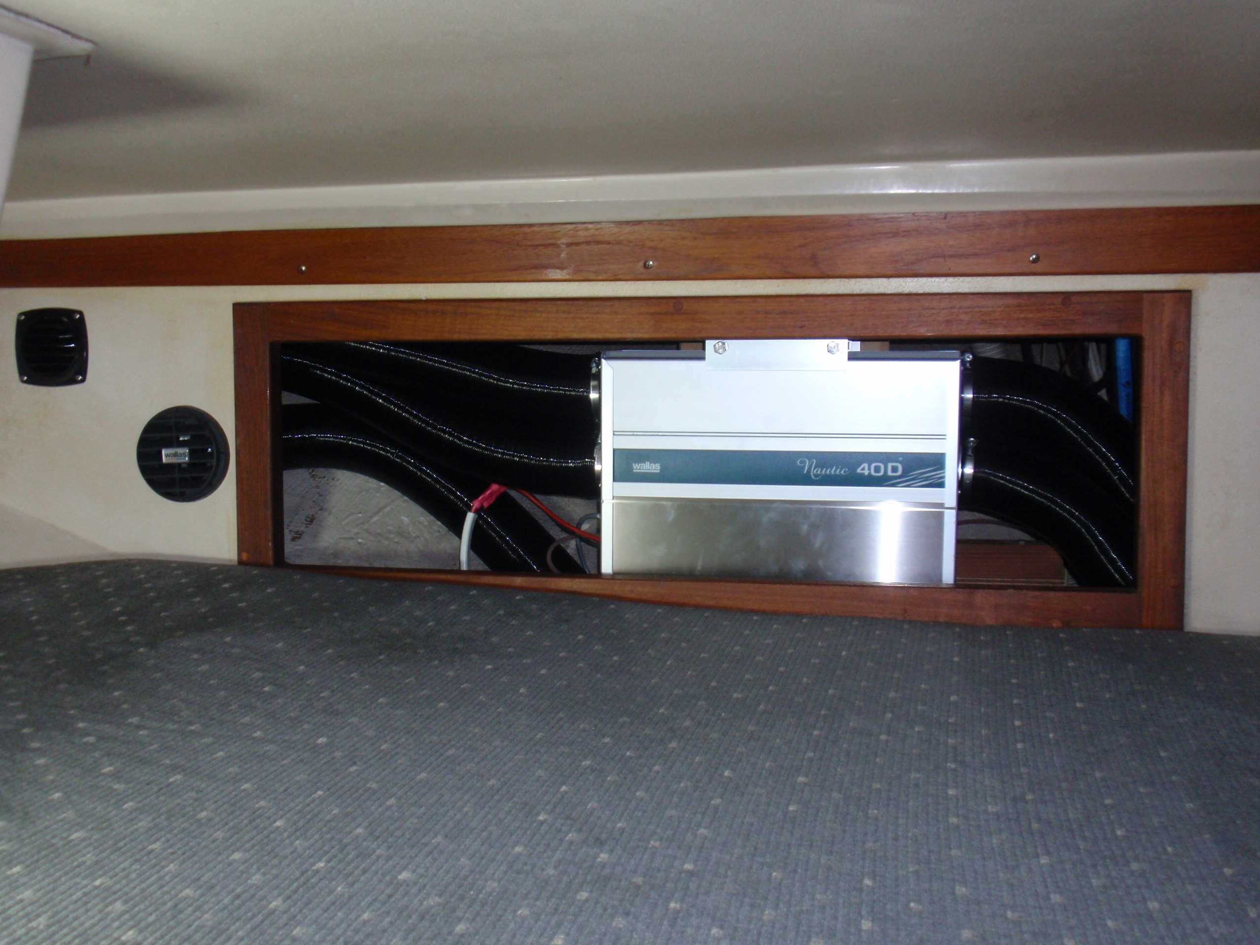

Here's a picture showing the final installation of the unit (Model 40D). I don't have any pictures showing the duct runs. The unit hangs from a bracket that I had to create a mounting spot for. It just barely fit into this spot. I've got 4 outlets. One in the aft cabin. One in the galley. One in the main salon and one in the head. Since I was replacing an old Ardic 041D, there was already a fuel line, exhaust port, and duct runs everywhere except in the aft cabin. The Wallas uses larger diameter ducting, so I had to replace that. Fortunately replacing the run below the icebox wasn't difficult. A couple dock mates tell me my unit is far quieter that their Webastos. If you want more pictues, let me know and when I'll take a few more next time I head up to the boat.

Nice job and an excellent location. I'll bet that was fun. :D
Mark, how did you run the exhaust? How hot does that pipe get? Their literature seems to show the two smaller units (22 and 30) with double walled pipe but the biggest one (40) with single wall pipe which is odd. That is probably going to be our biggest issue given where we are thinking of mounting it.

The exhaust runs back and out the transom. You've got to have some rise in the pipe prior to it exiting the hull to minimize the chance that water can be pushed up the exhaust and back into the unit. I think I have only the bare minimum rise. I already had an exhaust port in the transom from the old unit. The exhaust pipe is single walled and wrapped with some sort of fiberglass insulation. I don't believe it gets too terribly hot, but I can't give you a number. (I've been wanting an infrared temp sensor tool, so maybe I'll use this as anexcuse to go get one!) I expect the guys at Scan Marine probably could tell you more precisely. They have a demo unit in their showroom and are very helpful. If I pick up a temp sensor tool, I'll put it to good use next weekend and get you some numbers!
