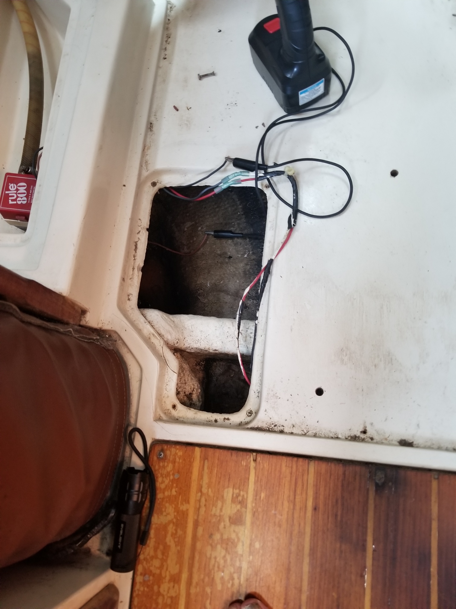

Hello 36'ers
I really need some help on this one

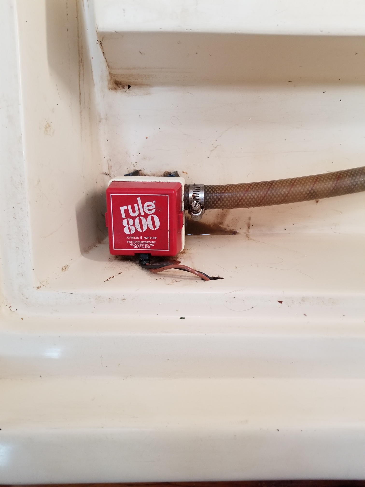

this is my shower sump pump and I have determined that there is no 12v going to pump. I have used needles to pierce the wire and I am able to run the pump with a jumper battery. there is power at the switch and not at the pump. I can pull the brown wire out to the butt connector and the black wire can be pulled out a ways and not to the the butt connector.
Has anyone replaced this pump? I am thinking this may be a case of corroded butt connectors if I can only find the connection for the balck wire.
PLEASE HELP!
thanks

I replaced this pump a while ago (actually, replaced it with a Whale gulper pump located elsewhere, but that's a longer story).  If I recall correctly (and it was quite some time ago), the black wire runs under the floor back to the  negative bus behind the main distribution panel, so you should try to trace that back to there.  The brown is the positive, it should run from the pump to the switch in the head, and thence back to the main distribution panel.

Hey 36's

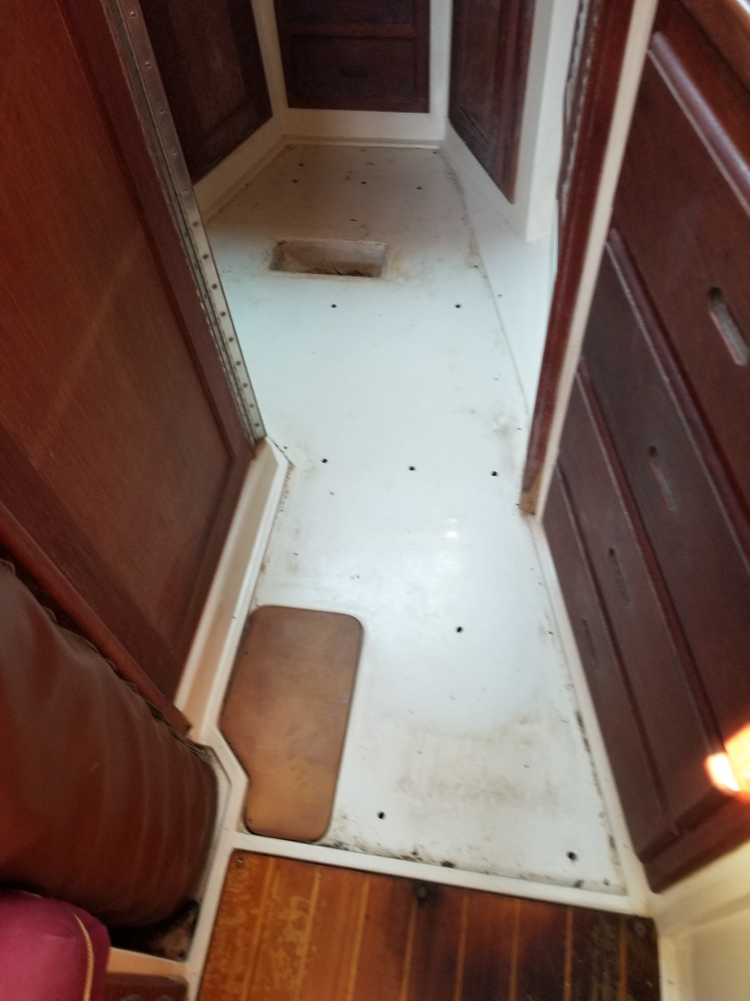

So I sent in a HELP!! message about my shower sump pump not working and got a great reply from Jerry with hull# 716 an 87 MKI. He told me about the inspection hatch under the floor boards for our boats (see pics).
Well I found the connections and cut the wires to te pump and tested the pump with my jumper battery. Pump tested like a champ!
 That made me wonder why or what the issue was with no voltage going to the head for the sump to work.
Well long story short.

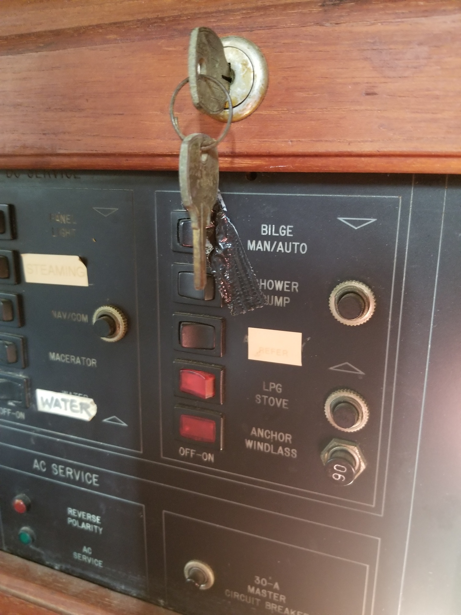

There is a funny switch on the panel called "shower sump". Now it was pretty amazing when I flipped the switch and there was power to the switch and and the pump!
Honestly folks I haven't used that shower in years because it didn't work. Keep in mind I have only been racing the boat and an occasional few day Island trip.
I am living aboard now so the convienience  became a little more important.
Yes I was calling my self a dumbs#%^t for the rest of the day!
Hey I learned about the inspection panel under the floor and had a great big helping of humble pie to boot!
Thank you Jerry for the replies and the point in the right direction!

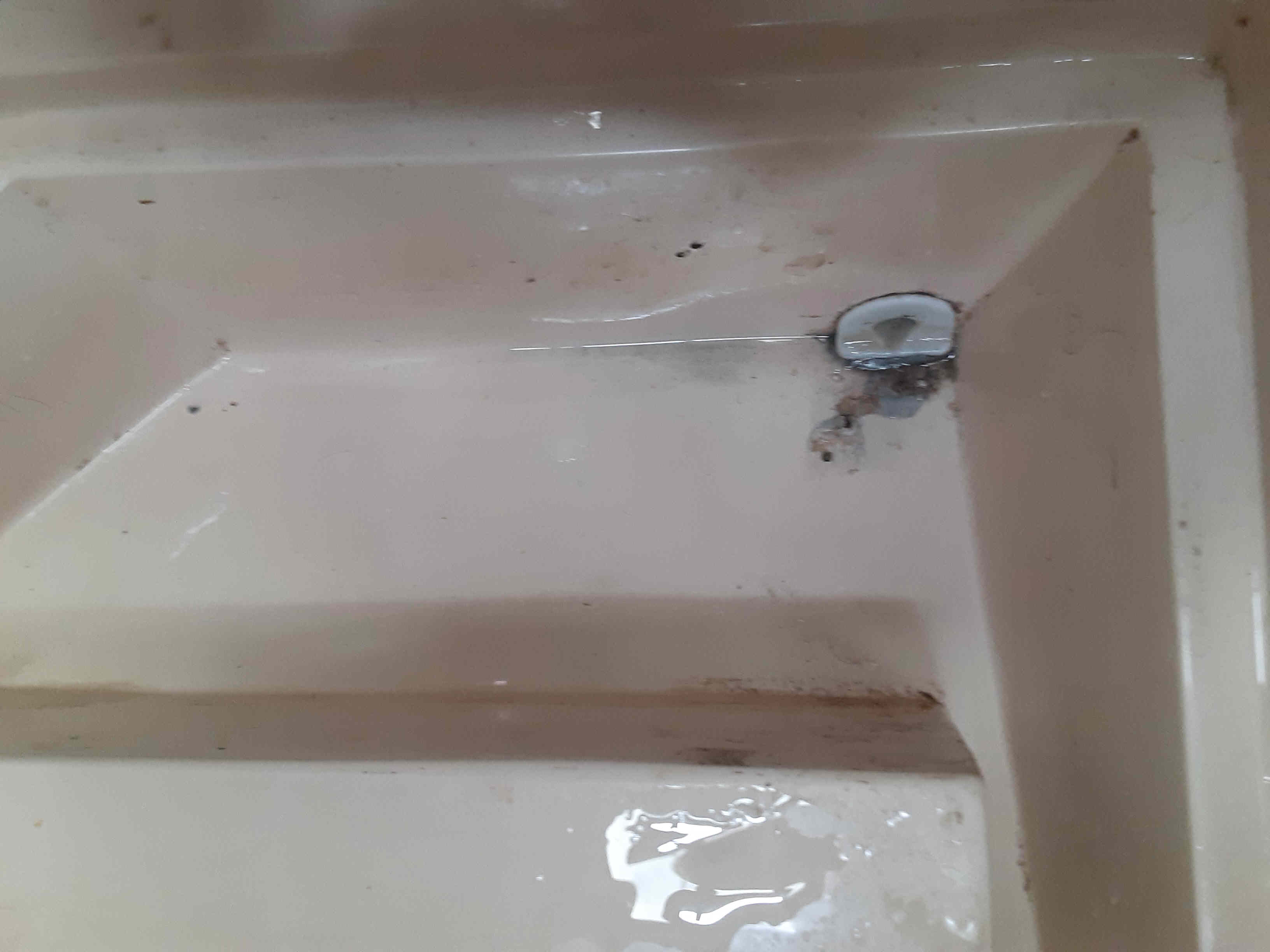

I replaced ours with a 'low profile' automatic Whale pump (yellow) with a built-in backflow valve, then added TWO backflow preventers by re-routing the hose around the center bulge to prevent the water trickling back into the pan, then added a filter between them to reassure the Admiral that her hair would get filtered out.  The latter needs regular cleaning.  Works fine after 5 years of regular use.  I use the switch in the head after squeegying the interior after a shower to eliminate most of the water and I leave the floorboard up leaning against the aft wall to ensure it dries out completely when we're away from the boat.  Also added an additional drainage hole on the starboard/aft upper edge of the pan in case the battery/sump fails to protect the cablin floorboards.

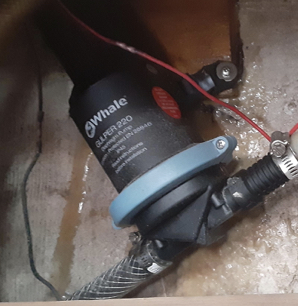

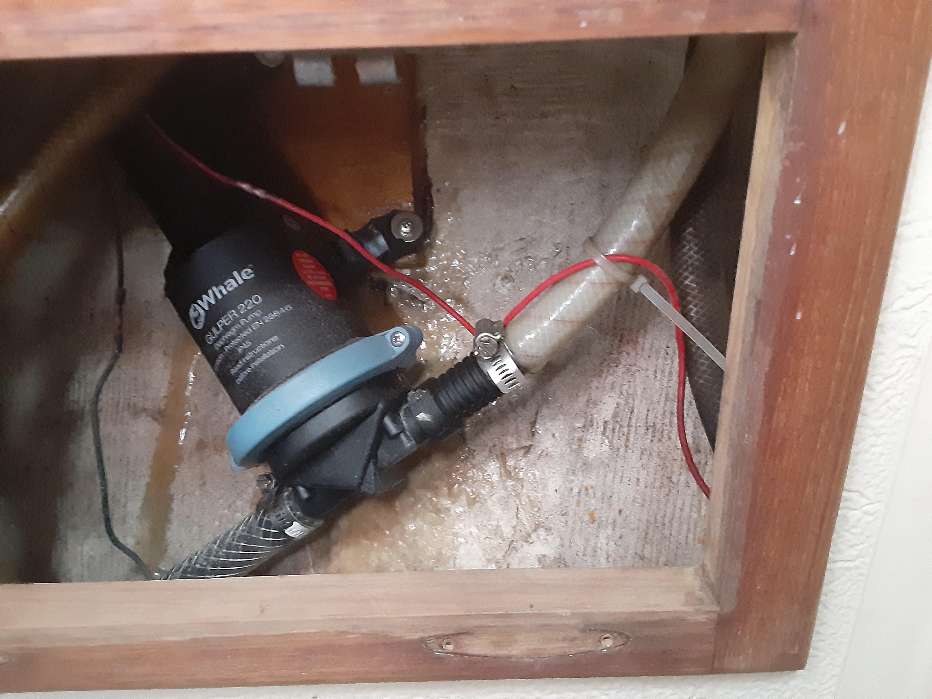

  We replaced ours with a Whale "Gulper 220" pump that is located in the unused cavity behind the little foldout door over the toilet (you need to remove the hinge screws to get in there).   We installed an offset mushroom through-hull (also called an "L-head") at the lowest spot in the sump, ran the hose from there under the floor of the cabin (there is an access port under the floorboards -- see the first picture in response #3 above) then back around under the forward bench of the port settee, then through a small hole from that area into the space behind the foldout door to the pump.  From the pump, the line goes to the syphon break in the cabinet above, then down to the drain seacock.  (The existing exit hole from the sump we glassed over).
 The Whale pump removes ALL the water from the sump, no need to mop out the last bits that an immersion pump can't quite get at.
