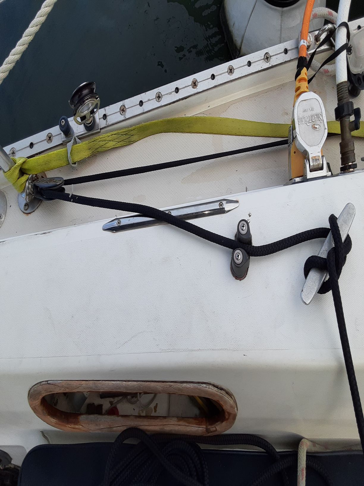

Mike, We faced a similar problem and thought we could add a rachet block as the final block. Here is a picture of our configuration on the port side. Our furling line comes back to a three inch (selectable on-off)  rachet block and is then locked in placed by a traditional cleat. A jam cleat could be used in place of a traditional cleat. The heavy line is of course the jib sheet and the black block is the roller furling line going aft to the rachet block, then coming forward. The aft section of the boat is to the left of this picture.

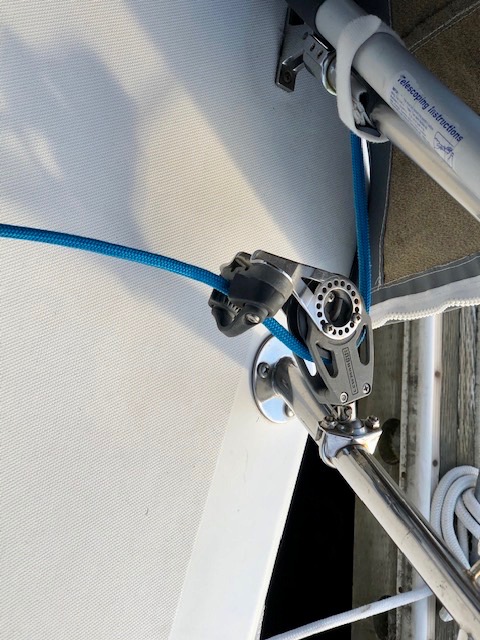

This is what we use.  It's important that the block ratchets, locking rotation in one direction.  This allows you to easily pull in to furl the sail but provides some tension when reefing for a tight furl.

Ratcheting is good idea. I like that rig. Garhauer? One question. Is this the forward most stanchion on the pushpit? Just trying to understand the line of pull from the helm seat. Mine is port side but that is not a factor.

As I recall the ratchet block and clamp were purchased seperately, but go together in an intuitive fashion This particular block is Lewmar, but we used Harken in the past.   Strangly enough I couldn't find a ratchting block made by Garhauer at the time.     You are correct that it is connected to the base of the forword most pushpit stantion.
Along with ratching it is important to be able to vary the angle of the clam cleat.   It’s hard to explain, but emagine if the cleat was pivoted foreword, it would be hard to cleat, pivoted back to far and it’s hard to release. Not really that fussy but there is a sweet spot allowing easy cleat and uncleat. I can take more photos if it will help but I currently have the reefing line off, changing the line.
