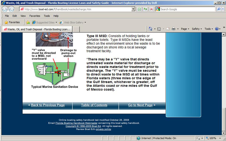

It is surprisingly (maybe not) difficult to find the law on the web. This is the first one I could get (see last sentence on web page).
[url]http://www.boat-ed.com/fl/handbook/wastedischarge.htm[/url]
Duane, thank you. Ya learn something new every day. I teach the Boat Ed course for the Oregon State Marine Board, but that has never been mentioned *even though* they spend way too much time talking about the ICW! This discharge restriction must be due to a local (ie, State of Florida law), not a federal regulation.
You are most welcome, Larry. The issue here is that state waters extend the typcial 3 miles out on the Altlantic coast, but 9 miles out on the Gulf coast, almost certainly due to the very shallow water in the Gulf. This affects, for example, the age limits for wearing of life jackets, discharge regulations, and all the fishing rules one must abide by.
If you go 10 miles into federal waters and catch the legal limit of certan fish, once you cross into state waters on your way back home, you have OVER the legal limit. It can get very contentious as you could imagine.
