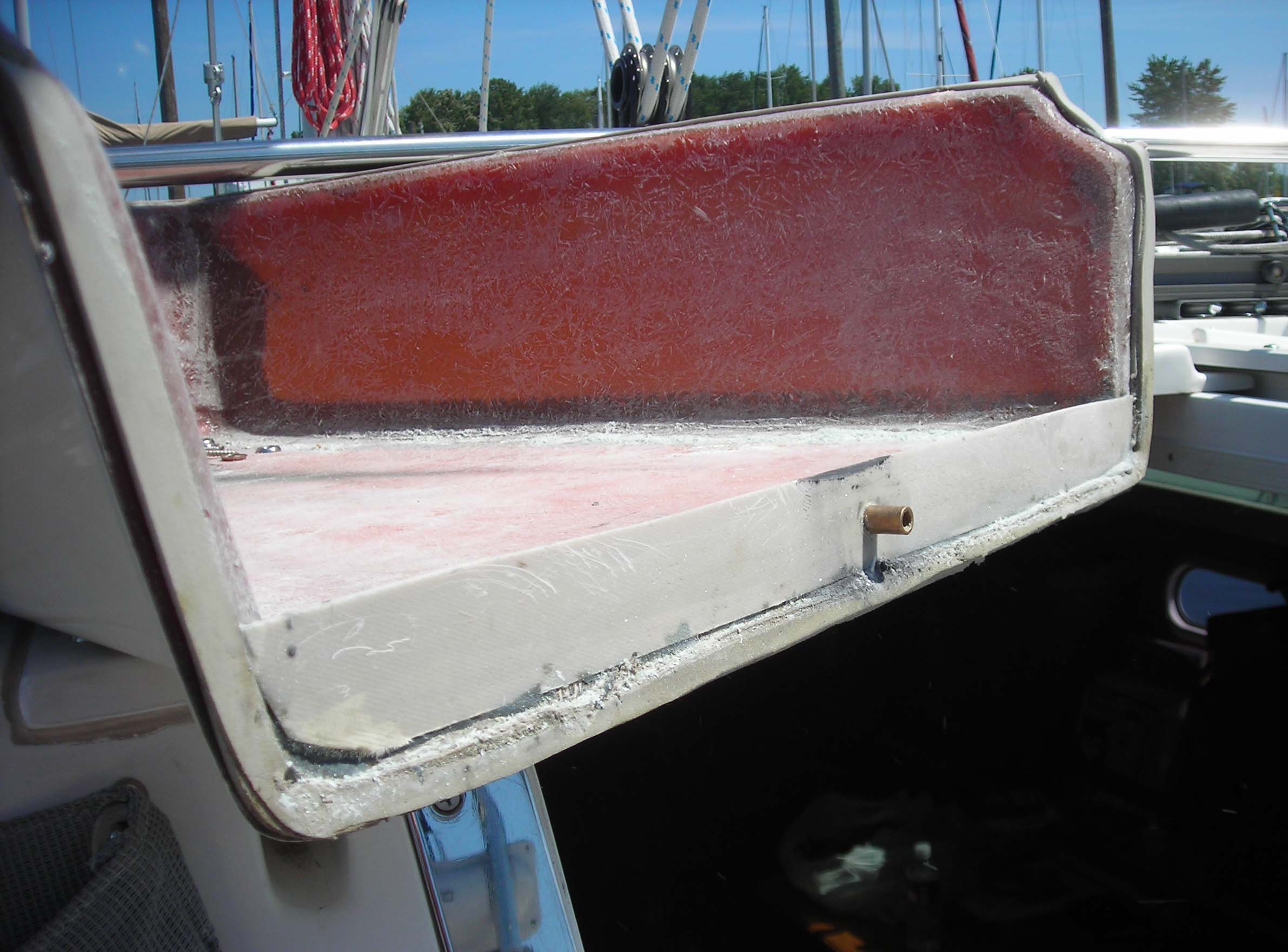

Suspect #2 may be more likely...and I know this from personal experience. The bases of the stanchions at the binnacle, and the wire and cable passages beneath the binnacle, are extremely difficult to seal completely. Any water that enters the binnacle (such as at the joints beneath the compass) and any water that leaks through the bases of the stanchions, where wiring from the navpods exits into the aft cabin, will drip into the cover (overhead of the aft mattress) and then run down the back cabin bulkhead to thoroughly dampen beneath the mattress. I have struggled trying to seal these areas properly and finally just surrendered. I had a fiberglass guy fabricate a "dam" at the aft end of the cover, install a small tube through the dam, and then drill a hole in the aft bulkhead to allow the tube to carry any water into the lazarette. This completely solved the moisture problem in the aft cabin. See photos.
