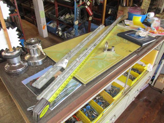

I was able to measure the thickness of the mast wall at 3/16” (measured at the base of the mast where the wires exit the mast).  My 72” track has 38 holes, I am probably going to use 19 screws (every other hole).  I was able to buy a used track & hardware from Minnie’s Yacht Surplus and am having a local company bead blast the track and then powder coat.  Good service from Minnie’s in Costa Mesa, California-I live in Wisconsin and Minnie’s sent me pictures of the available inventory.
