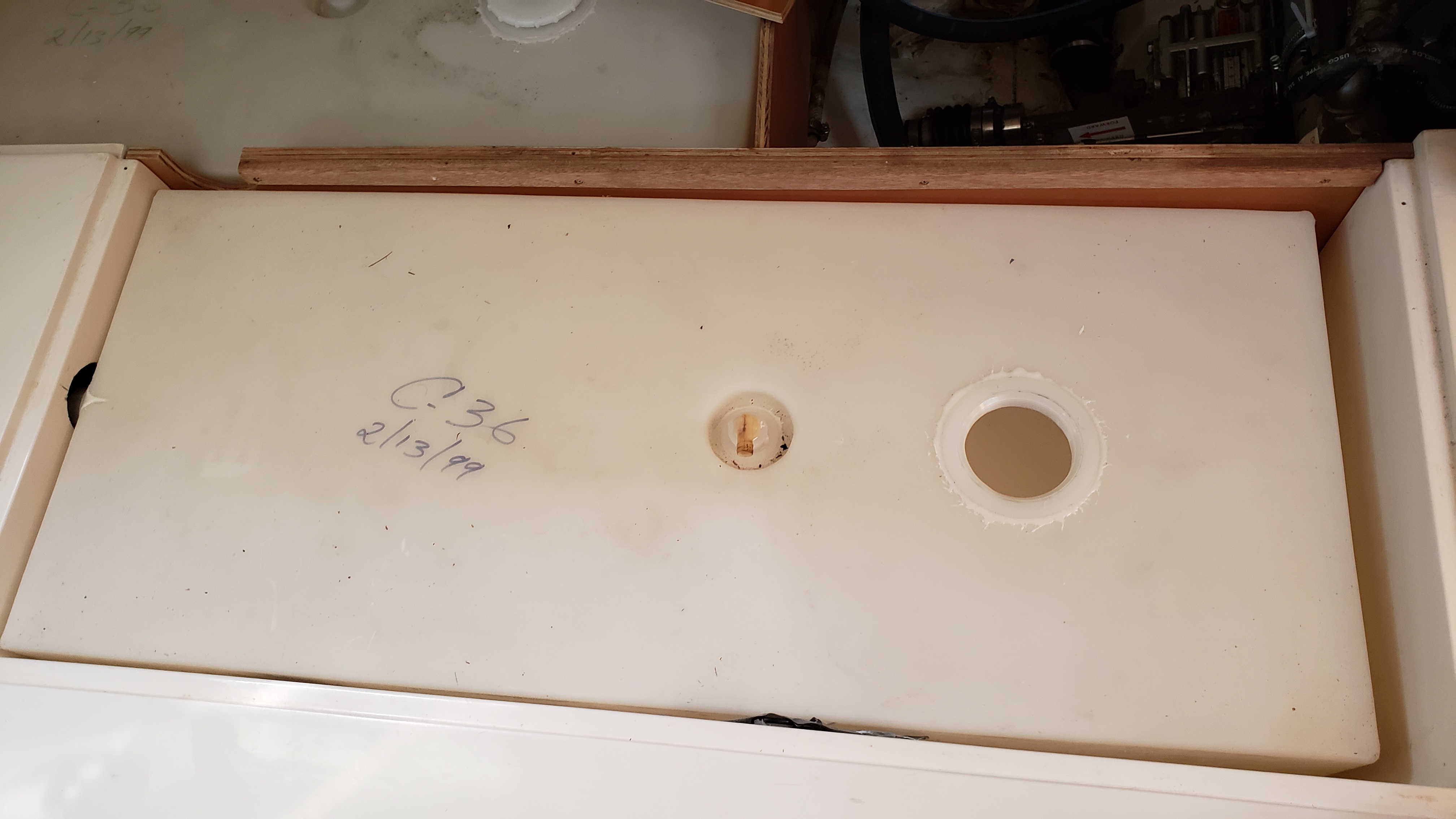

Hi there, I think my stbd tank is leaking and contributing to the water in my engine compartment and eventually the bilge  (earlier post regarding excessive water in bilge).  Has anyone ever removed one of these tanks before?  It seems to be quite a puzzle.  After removing the breather off the top of the tank, I thought I would be able to shift the tank aft to allow room to disconnect the supply line (out the bottom forward), then shift the tank fwd and disconnect the filler hose from the aft end.  There was NOT enough play to do this.  In fact the tolerances between the tank and the molded form of the boat leads me to believe there must be a better way.   I've added a picture to reference, hoping someone has been through this and can talk me through this process.

it’s been awhile, but if I remember correctly, you have to remove the plastic outlet fitting from the bottom, front of the tank in order to lift it out. I’m pretty sure you get to it from the compartment in front of it. All ours leaked when we bought the boat new. They had minimal Teflon tape on the threads. Also, be aware that the large inspection port on top is famous for leaking around the threads, especially if you really fill the tank up to the top. The plastic tank bulges and the port weeps water.
I’ve found, over the years of working on my boat, that most everything is accessible/removable. Catalina did a first rate job of making this boat easy to work on.

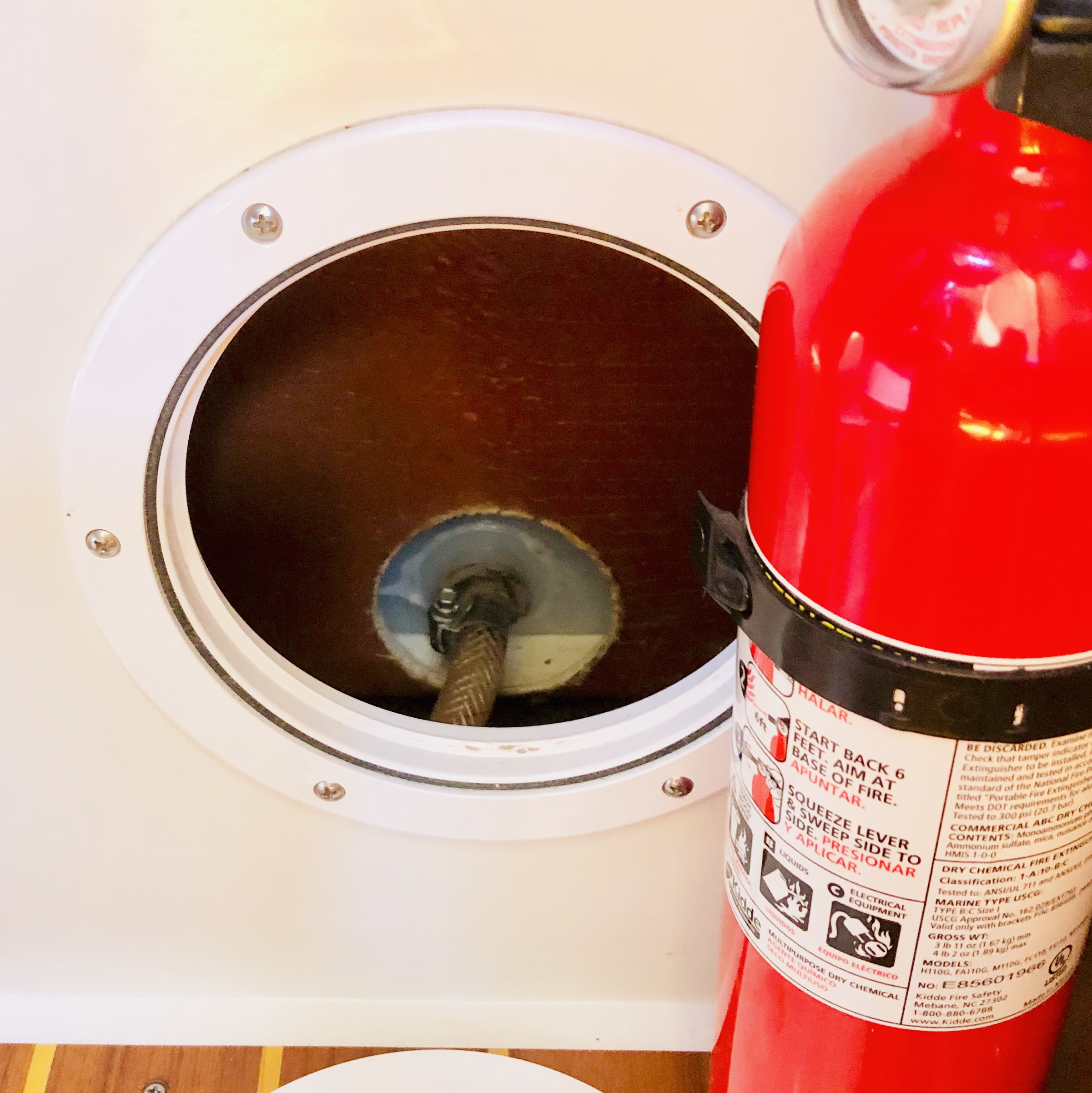

Hi again Wally. Not sure if that hatch (that faces fwd that gives access to the raw water seacock and I suppose the fwd plumbing on the tank) is something Catalina added on later boats, but our 1999 does NOT have it. I know what your talking about because I saw it on my friend's 2005. But on our 1999 it's a blank wall and the seacock is tucked away in the engine compartment, aft of the transmission and just to stbd (pita to get to). I'll check next time I'm aboard but I'm wondering if there may be some kind of access in the storage well, to the stbd side and fwd of the tank...
Wally-1840
Joined: 11/9/09
Yep, you’re right. I’m on the boat now and have included a pic of my setup. It was 19 years ago that I did this, so forgive an old guy! I remember that I installed this access plate. Looking inside, there seems to be no other way to get in there. I assume the tank won’t come out by lifting from the back first and “angling” it out? The access port is on the bulkhead right in front of you as you enter the cabin.

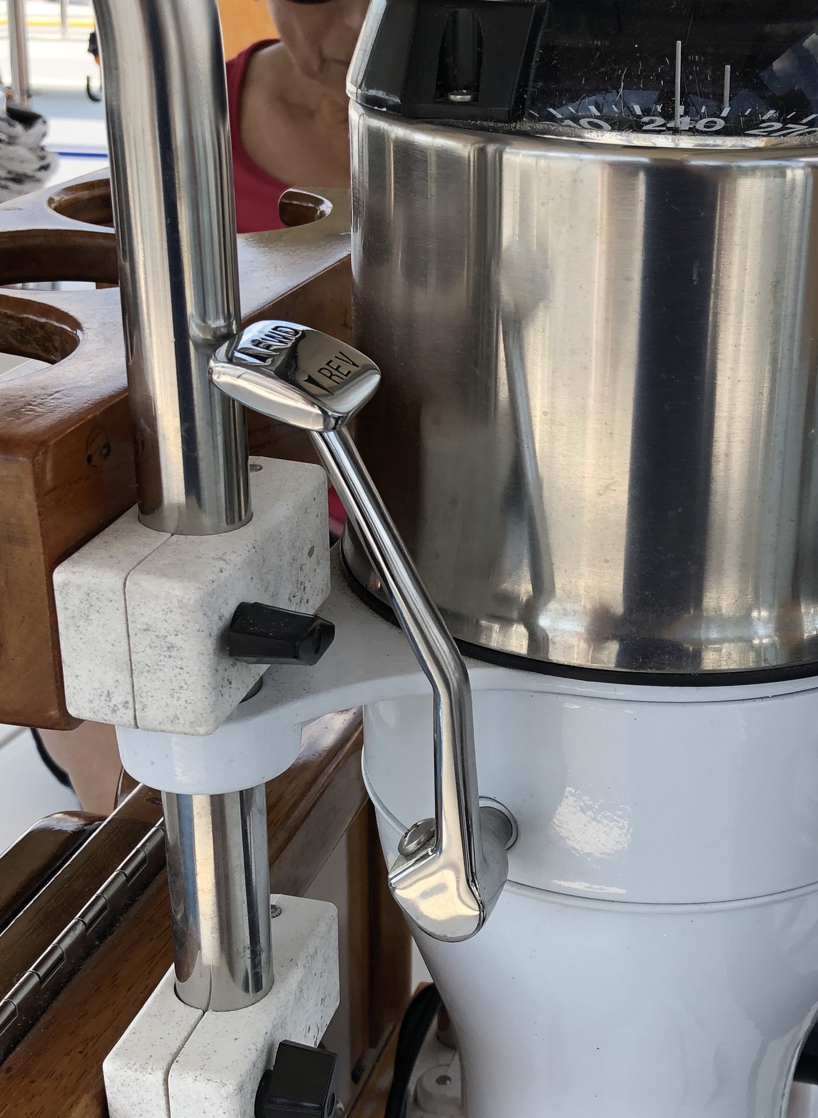

ive also included a pic of the “somewhat straightened” shift lever.

Wally, thanks again. Both pics hugely helpful. Seeing that access port will give me the confidence to make the cut. It looks like the tank is set far enough back that I'll be able to use my roto zip and set the guard for a very shallow blade depth. What diameter access port do you have there? Can you reach the raw water thru-hull through that access?

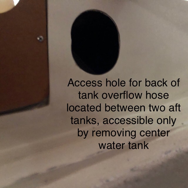

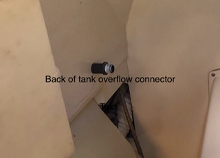

I thought one of the aft tanks was leaking.  You have to remove the port side tank first, which happens to be in the very middle of the boat. That one is very easy to remove. In order to remove the starboard tank, the port side tank has to be out.  There is a small access hole behind the Starboard tank, on the fiberglass wall that separates the two tanks. On my boat, hold number 1897 manufactured in the year 2000, this hole could be made larger and also have an access port from the top.  Very uncomfortable position for the repair guy, otherwise known as me. You have to remove the two clamps that attach overflow hose, turn disconnect/remove over flow hose. Then unscrew the gray connector from the aft of the tank.
Now you can lift the AFT end of the tank to access the connector at the front of tank feeding water to pump.   I tried to remove the approximately 1/2" flexible lines from the hose hose fittings but couldn't do so.   On my boat there was excess hose length so I opted to cut the hose off about an inch from the 90 degree tank elbow connector fittings.  My boat is 20 years old and the inside of the fittings was gross.  We could have replaced these elbows but opted to soak in  1: 3 (diluted) solution of bleach & water.  I took out my tanks, plugging the elbow at the front of the tank (sharpie pen in hose stub worked well) and filled with water to make sure tank wasn't cracked or leaking.  No holes or cracks found.  Time to reinsert elbow connectors: Wrapped the cleaned elbow threads with white plumbers tape, gently tightening.  Warmed up hole ends with heat gun and re attached hoses.
It is very important to look in through the top of the tank access hole to see if there's any crap in the bottom of the tank.  What I found was disgusting....reason to NOT seal access hole permanently. Pictures coming soon.  I think my leak was at the elbows.
