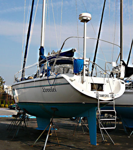

I have a wing keel with a rudder that is shallower than the keel. One of the pictures posted above has the semi-elliptical rudder that came later than '95. I don't believe that they were offered as stock on the wing keel boats.

RubyBlu -- your boats' rudder and keel config looks exactly like the 1995 C 36 MK II (Hull 1467) that I have had sea trialed and surveyed yesterday. What did you end up doing about this -- that rudder is definitely longer than the keel! I'm going to use the boat for cruising in the Albemarle/Pamlico sound area in North Carolina, so really prefer shoal draft. However, I do not think a rudder that's 10-12 inches longer than the keel is a good idea!

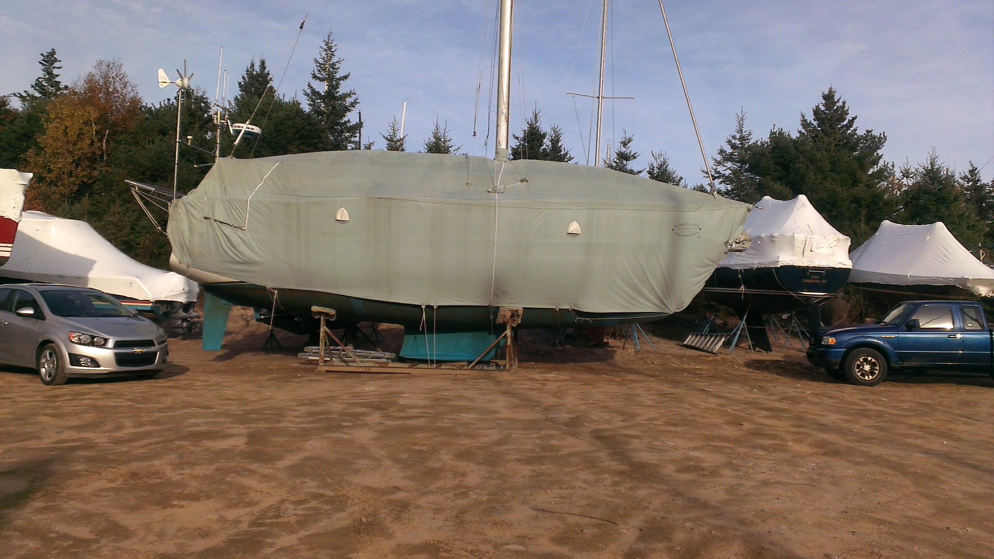

Not the best picture of a boat, but it does show the keel and rudder. I will measure next time i am outt to the yard. 1990 mk1 Northern Symphony - near Chester Nova Scotia. That's in Canada, eh.

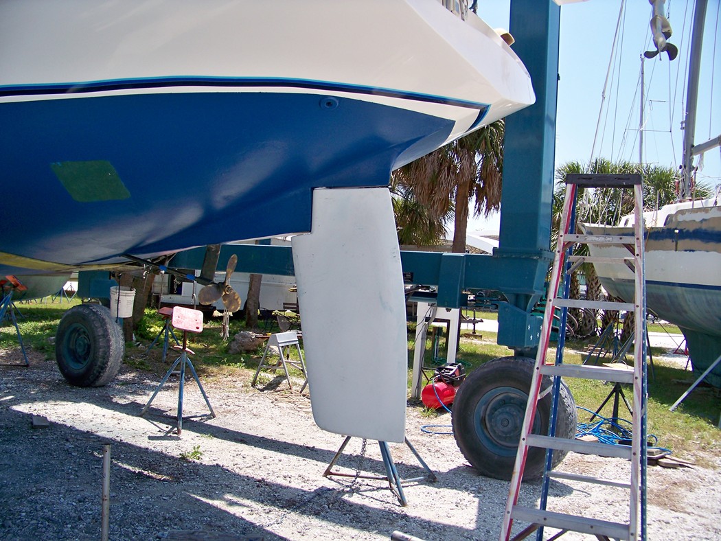

Attached are two images of a 1995 Catalina MKII Rudder.
Wow, even with the photo perspective making an accurate determination impossible, it sure looks like the one rudder is much deeper than the keel.
Like I said, Ruby, I was 'going' to refute your statement until I read how Catalina switched to a shorter rudder after an obvious initial mistake.
Thanks for posting those pics.
