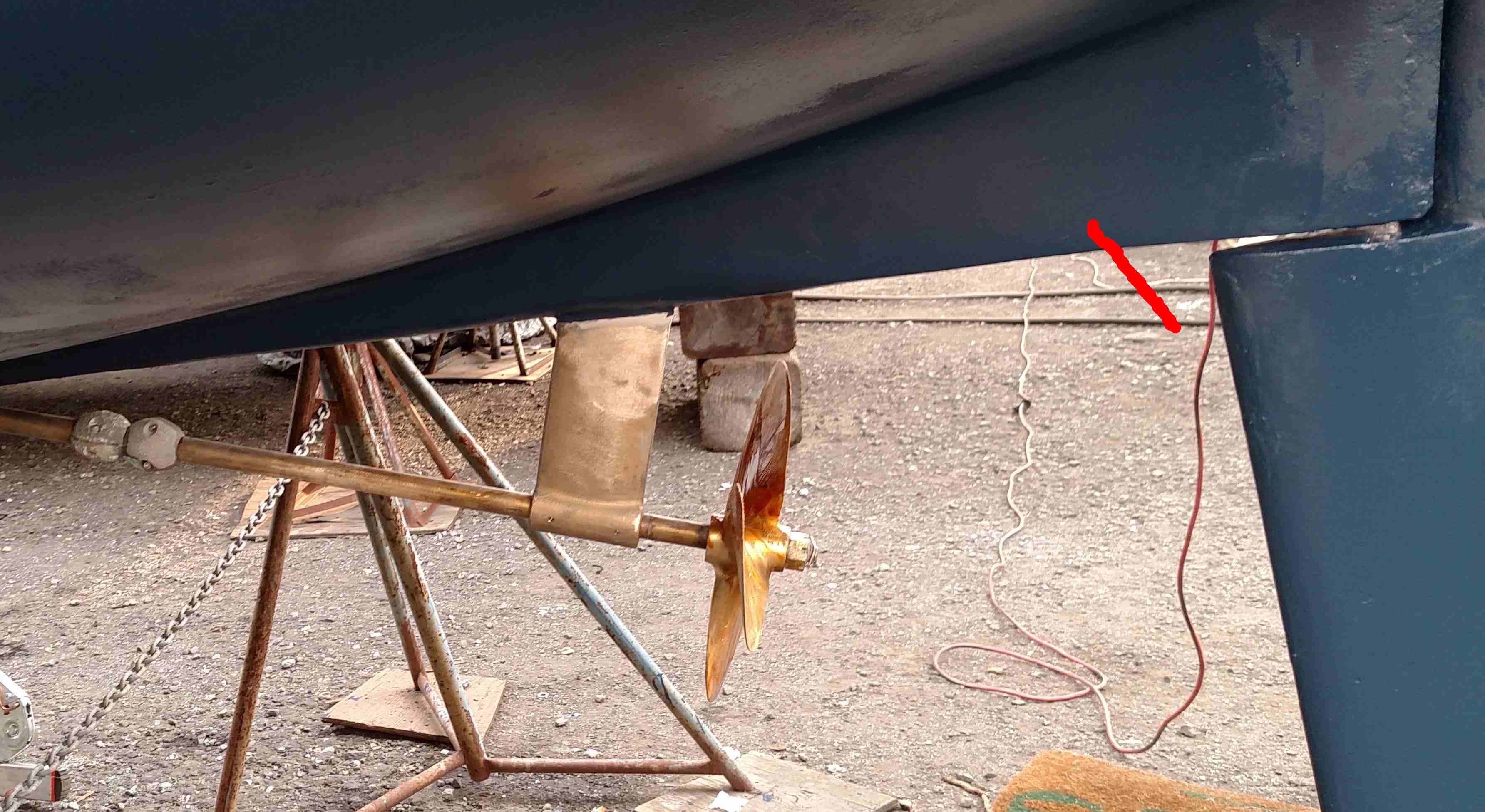

I've seen the picture of Tom Soko's installation, but I can't find it anymore.  Try sending him a PM via the site, perhaps he has it and can send.
From my recollection, he basically glassed in a short rod or bolt into the fin just before the rudder, at an angle.   I'm attaching a photo of our boat (just after I finished replacing the prop shaft skeg) with the position/orientation of the deflector maked as a diagonal red line (again, this is all from memory).   I don't recall precisely where the fin is solid glass (as opposed to where you would be putting a hole through the hull where it is open to the inside); you should check around from the inside.

Matt-
Here's an unrelated question to this thread. It appears that your propellor is located a fair distannce outboard of your strut/cutlas bearing. I don't recall the rule of thumb guidelines (some number times the shaft dia; 1.3XDia???). Anyway, what ever the guidelines are, your boat seems to exceed them. Have you ever encountered vibration problems?
Something I didn't know I had to worry about.  But no, never had vibration problems from the prop shaft.

Thanks Matt,
This is pretty much how I envision it too.   30 to 40 deg angle per Tom's observation, with the post end as close to the rudder as feasable.  I suspect the keel area in fron of the rudder is solid but checking is sound advice

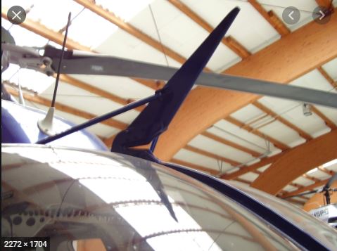

Interesting idea Larry.  In helicopter aviation they use something similar called a Wire Strike Protection System.  Most causal viewers probably think its an antenna, but the blade-like shape sticking up above the cockpit is a shear point for cutting a wire if the pilot should ever inadvertanly fly into one.
Your idea is interesting.  Wondering if some kind of a knife edge jutting down from the keel or the shaft log would do the same.  It's hair-brained, yes.  But all good inventions start off this way.  Here's a pic of the WSPS..
