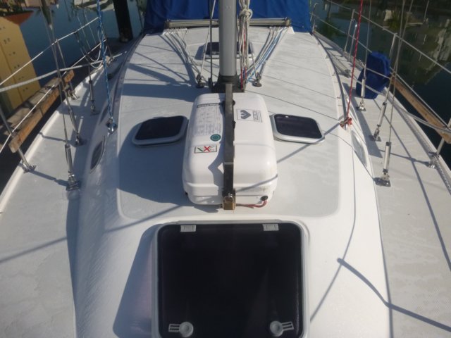

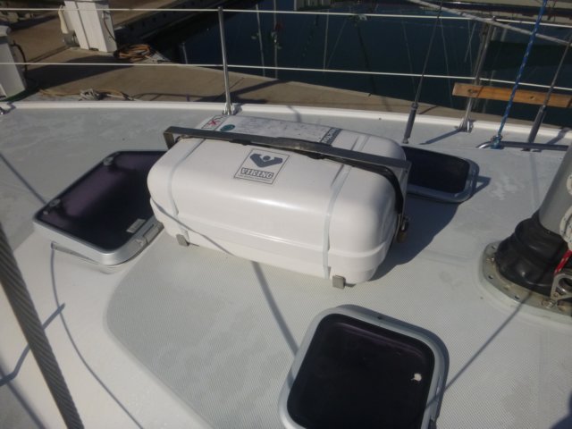

I never did update the original message. We purchased a 4 person Viking 'Rescue You' canister version with a cradle. It was puchased direct from Viking in Long Beach. We mounted it on the foredeck between the mast and forward hatch. I had a special bar fabricated in Long Beach that goes over the top of the unit so I can lock the bar to the cradle at both ends. It is a sizeable investment. Obviously, this is not in place when sailing. We also have a cover for it when in port.
If there is any downside, the Genoa sheet sometimes catches under the cradle on the first tack, similar to what happens on the forward hatch. I usually remember to go forward after the genoa is deployed and move the sheets forward of the liferaft, then everything is fine. I would have preferred to mount it nearer the cockpit for ease of deployment in an emergency but sometimes you have to make adjustments. We have had it since 9/2011 and are happy with the arrangement. The pictures show it in place with its locking bar as well as a closeup of the lock on one side. I purposely moved it clear of the mast so I have space to move around the mast.

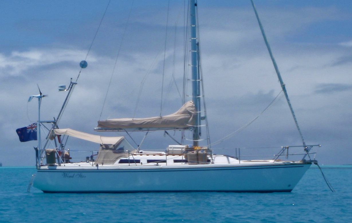

For our first voyage we bought a cannister and had a bracket made for the rail. Tried it over the transom, this was good but was in the way if we deployed our Jordan drogue. We moved it to the stbd. side, but this was vulnerable to waves and docking, as mentioned above.

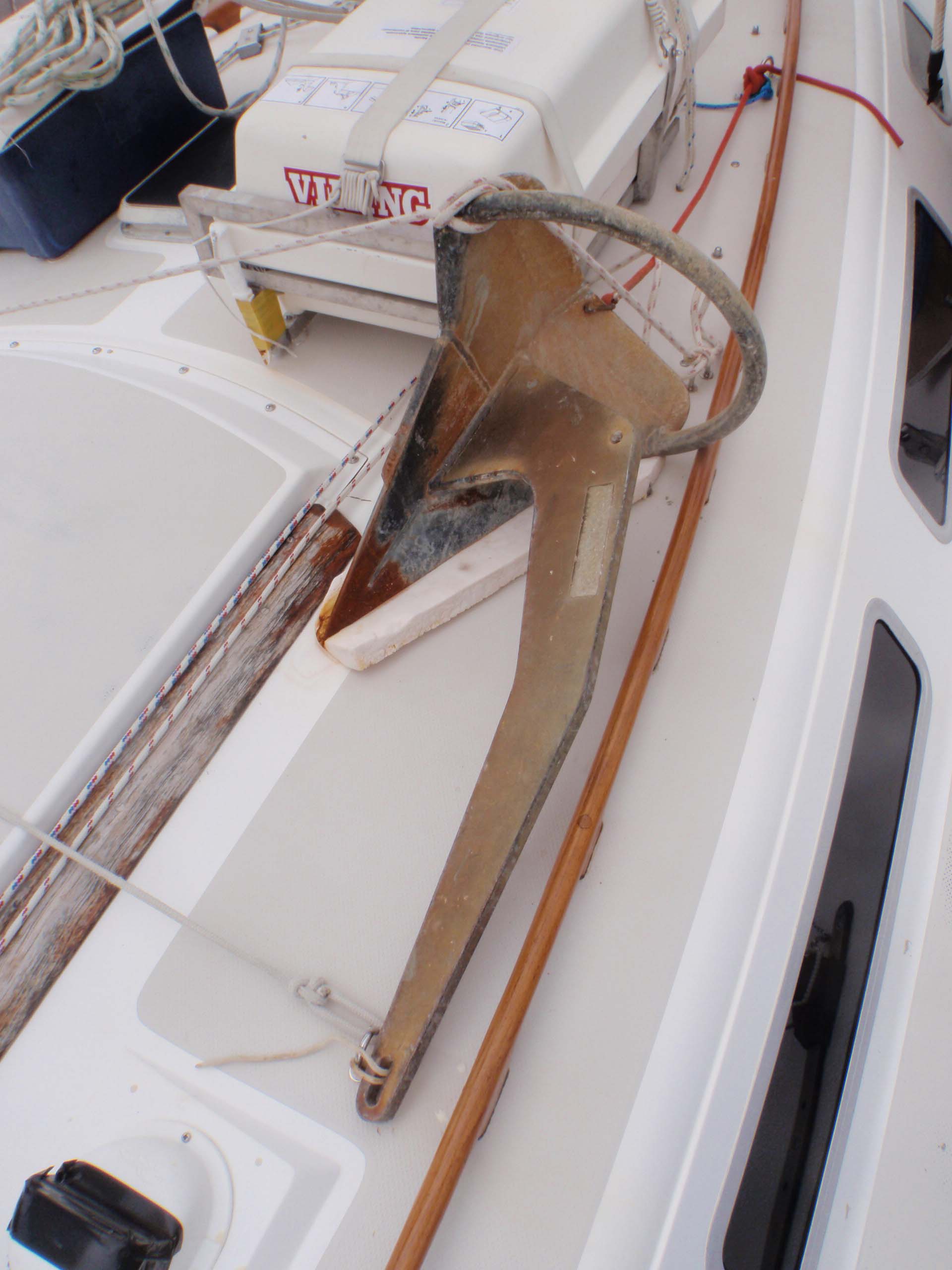

Then for our second voyage I mounted the cannister on the deck aft of the mast. This is a good place, but works for us because I've shifted the foremost mainsheet turning blocks aft near the dodger to avoid the spider's web of lines under the boom. The anchor is stored there just for the main passages...
Unfortunately poor old Wind Star looks a bit cluttered with all the junk we have to store up there... :o

I like the Rocna and wouldn't leave home without one. The 20 KG one I put on Hilbre last year has been WONDERFUL and proved its worth in a couple of nasty blows when other boats dragged. After two years I have had no issues with my Viking raft stored forward of the mast. It is out of the way and helps balance the boat for good trim and when on board, the dingy fits over it nicely.
