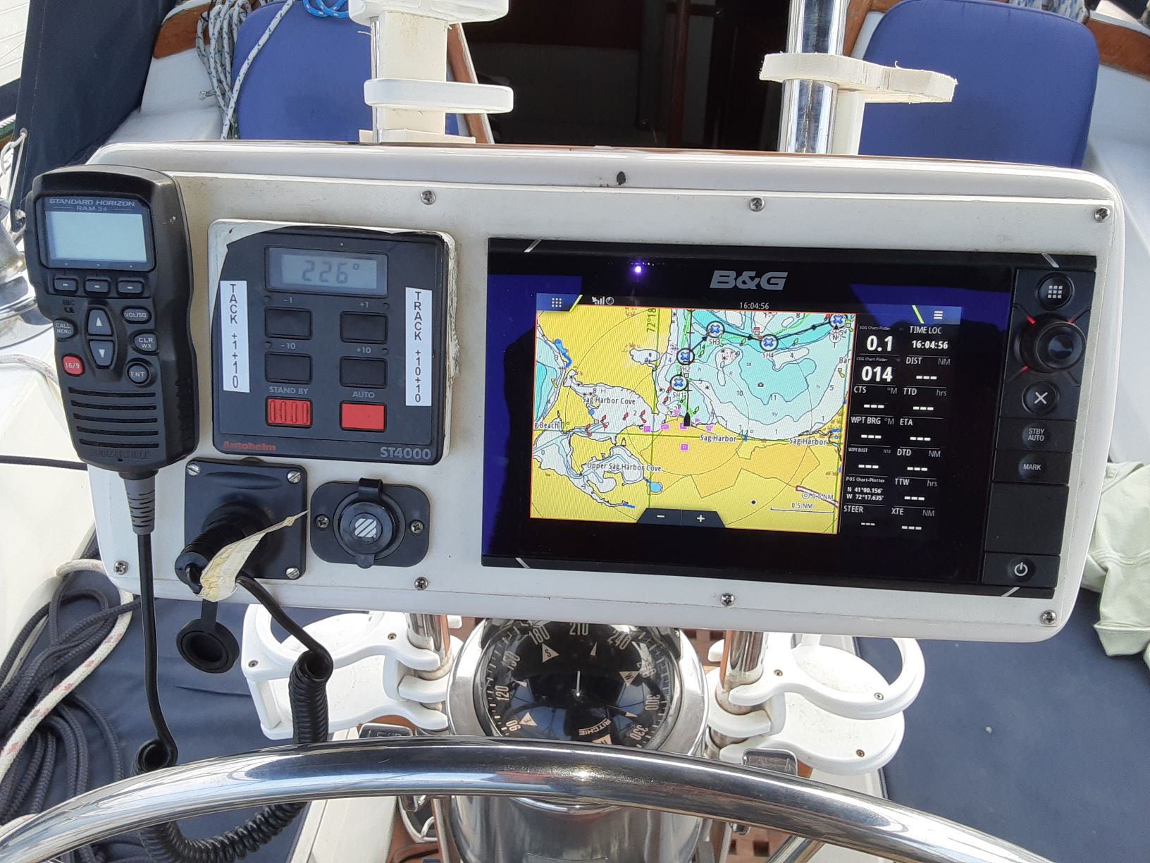

    FWIW: I very much like having a chart plotter at the helm, and to a considerable extent the newer chartplotters (which are multi-function displays, or "MFD") can handle most or all of the data that the individual devices displayed -- including, given your indicated preferences, wind, depth, and speed.   Our current system is a B&G 9" Zues 2,  and which is tied into the ST4000 (which operates on the older Seatalk network) via a multiplexer (http://www.shipmodul.com/en/index.html ), so that we can drive the ST4000 from routes in the chartplotter.   We also have a remote handset for the VHF at the helm (tied into the main Standard Horizon VHF unit at the nav table below, and also tied into the chartplotter via the multiplexer, as the VHF communicates via the older NMEA 0183 data).     The Zeus 2 replaced our earlier set-up, which had a seperate Garmin chartplotter and a JRC radar (both somewhat ancient, but still servicable); the Zeus 2 has both the radar display and the chartplotter.   The downside, however, is that the more you put yours eggs into the MFD basket, the less redundancy you have if the MFD fails....
  When changing out instruments, rather than buy a new instrument pod, we screwed a piece of starboard over the face of the pod and cut new holes accordingly.
   One consideration, too, is how many cables you can fit into the tubes of the pedestal guard.   We upgraded from the original 1" diameter to a 1.25" guard from Edson, which helped.
