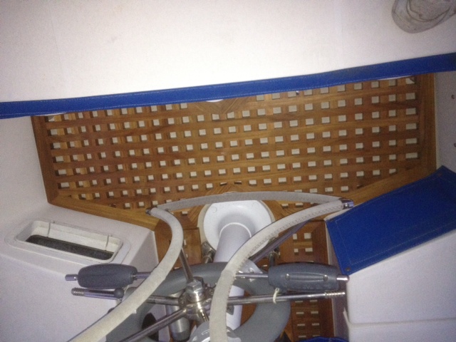

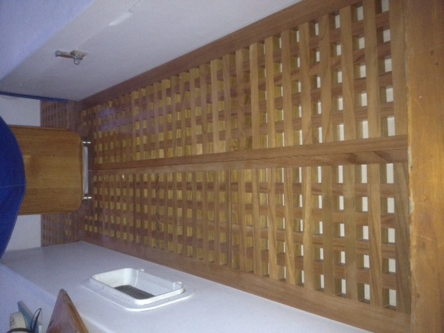

As promised here are a few pictures of the cockpit grate that I described. Taken with my Iphone so not great photos, but hopefully clear enough to get the idea

Thanks for the pictures, Paul -- they really help clarify how these are laid out.
Given what teak costs these days, the price for the finished product is quite good, and gives me pause as to whether its worth my while to build on my own.

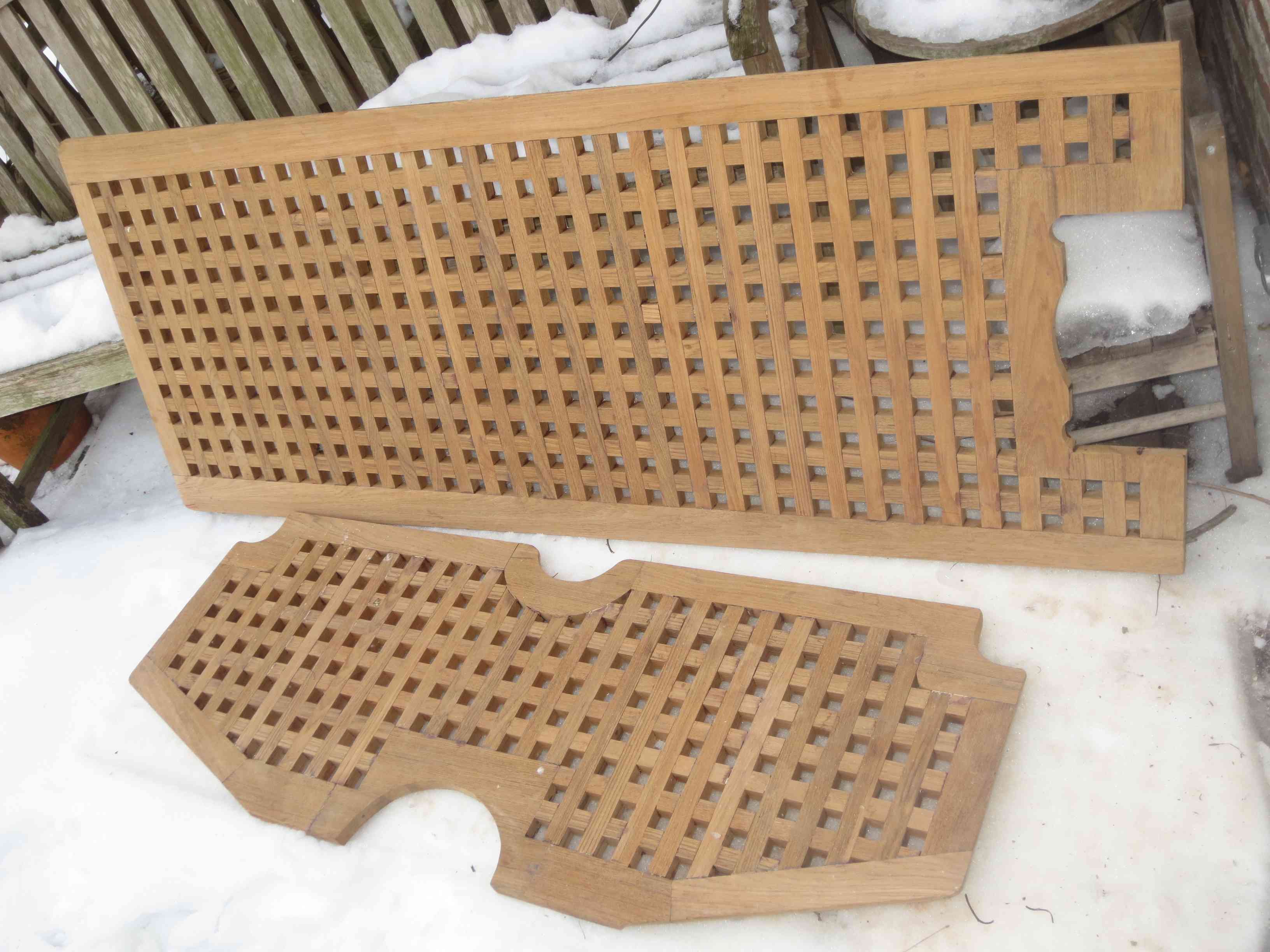

This winter's "wood therapy" project was the teak cockpit grate I'd been mulling for a few years.
In hindsight, I might have been better of following Paul's source for a custom builder; this was a lot of work, involving a lot of very careful setting up of cutting jigs and so-forth. But that's the therapy part of it, I guess. A useful resource was an instruction CD produced by a guy up in Newburyport, MA, who also custom builds grates ([url]www.theyachtshop.biz[/url](link is external)). With the price of teak at these days,the CD was worth it just for the mistakes I may have avoided (not that there weren't a few anyway).
Below is the outcome (awaiting application of a teak sealer), as well as a picture yesterday of the boat that it will be installed on once everything thaws around here!
Looks good, Matthew! Hope you don't have to raise the bimini an inch now.
