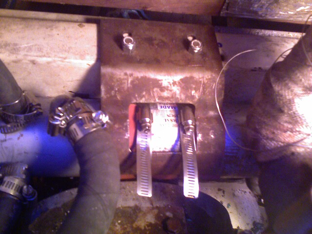

So two weeks ago I took the HX off so I could work on it at home, ran a drill into the broken zinc, chased out the threads, and Voila! It looked like we were good to go. But then I had to deal with the problem of getting all the loose bits of old zinc out (I had -- note the past tense -- the old 2" HX that the early M25s came with, where the port-side end was not removable). So with a lot of careful rinsing and jiggling, and some delicate jabs, I was able to shake out all the old zinc fragments. OK, NOW we're ready to go. I file off the end of the new zinc so its not too long, gently screw it into the cleaned out threads ... and oops, the entire fitting splits into 3 pieces. Quite rotten.
Oh, well, I guess the original HX had served its time (it did have a lot of green corrosion on the outside.)
So, on the advice of an earlier thread on this subject (and Universal's service bulletin from the early 90s that suggested upgrading to the newer style 3" HX), I purchased a Seakamp aftermarket 3" new style HX from AAA marine, it was a bit over $300 from the copper-nickel model.
It was a bit of a squeeze getting it in -- I ended up removing the old bracket from the engine and reversing it and bolting it onto the fiberglass crossmember instead. And the hose connections are not all the same size -- although pretty close. Fired up the engine today and it all seems good.

[QUOTE=Chachere;8388]
I'll try to post some pictures at some point.[/QUOTE]
Here's a photo of the finished installation (with the reversed bracket). Sorry, its not only a tight area to work in, its tight to photograph.
